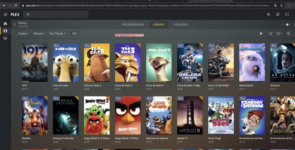

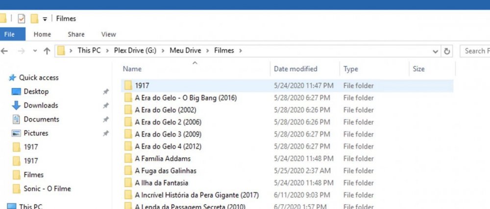

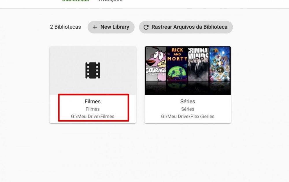

guluppi 1 Posted June 13, 2020 Posted June 13, 2020 Hello friends, I have Emby installed on a Windows server, I have a problem where he is unable to find the movies in the folder. The series he can find normally. I ran Plex and I didn't have that problem, Plex was able to find everything. Can you help me? embyserver-63727648741.txt embyserver (1).txt 1

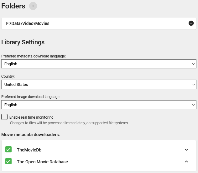

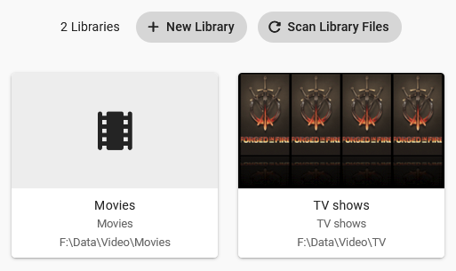

pdavis 1 Posted June 23, 2020 Posted June 23, 2020 I am in the process of switching from Plex to Emby as well. I have the exact same issue as the original poster. My Movie and TV folders both have the same permissions and are both located in the same parent folder. I have tried adding and removing the Movies folder several times and multiple library scans. F:\Data\Video\Movies F:\Data\Video\TV I tried setting up a test library using the movies folder but of type TV to see if it would find anything that way but it still didn't find any content. I have looked through the embyserver.txt log and have not seen any errors movie related. I can provide a log if it will help. Version: Emby Web 4.4.3.0 OS: Windows 10 Pro Version 1909.

Happy2Play 9814 Posted June 24, 2020 Posted June 24, 2020 1 hour ago, pdavis said: Here is my EmbyServer.txt file right after a library scan. embyserver.zip 4.5 kB · 1 download Oddly enough your log does not show your Movies library at all. There was a similar issue in another topic that a movie with in the library was causing it. Can you test making a new library and folder path and putting a couple items in it a see if they are found. Something like "F:\Data\Video\Movies2".
pdavis 1 Posted June 25, 2020 Posted June 25, 2020 20 hours ago, Happy2Play said: Oddly enough your log does not show your Movies library at all. There was a similar issue in another topic that a movie with in the library was causing it. Can you test making a new library and folder path and putting a couple items in it a see if they are found. Something like "F:\Data\Video\Movies2". Success! I created a second folder and started moving files into that folder. I started by moving just one file into the folder to confirm it worked. I then started moving about half the contents of the Movie folder at a time, running an index after each move on both folders. It didn't take too much detective work as when I went to move a batch with a movie with the title "Nausicaä" Windows gave me the error "Could not find this item: This is no longer located in XXX, Verify the item's location and try again". I moved every file from my Movie folder to the new folder and the new folder indexed without any issue. I have tried several hacks to remove the offending folder but Windows just refuses to recognize that the folder exists. I ended up just moving it into a temp directory in hopes it will go away some day Thank you for your help. I hope this helps others with a similar issue.
