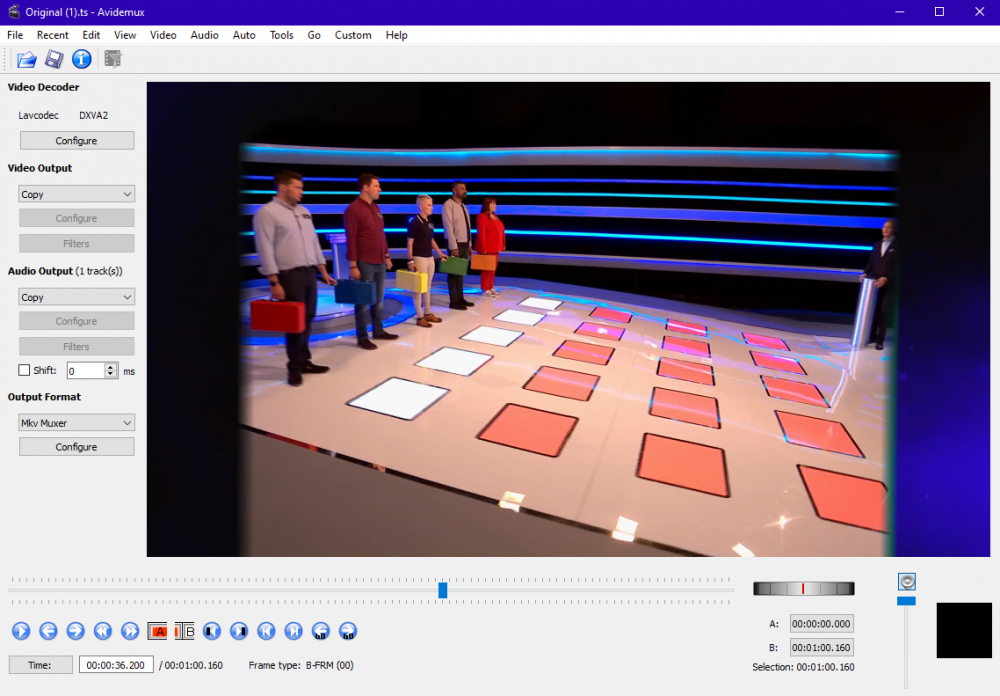

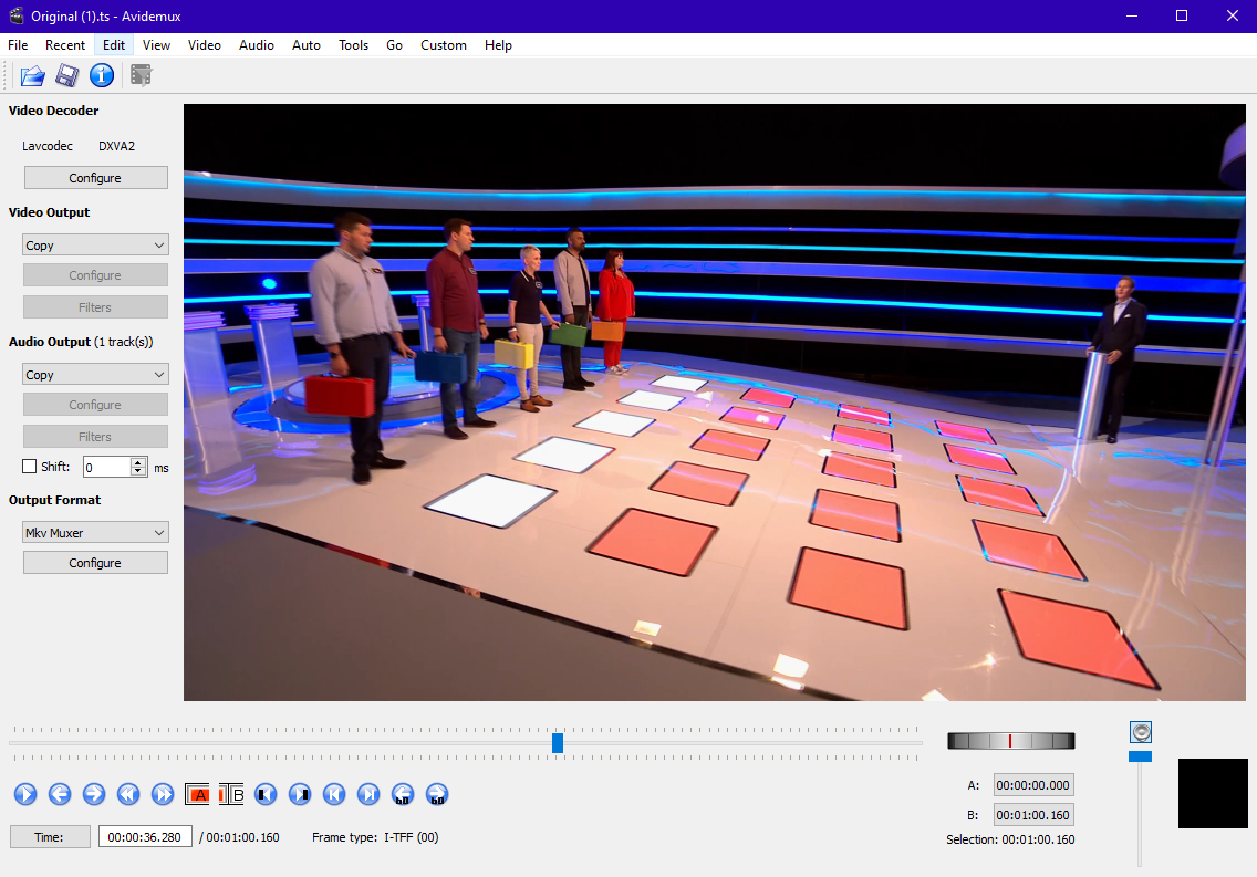

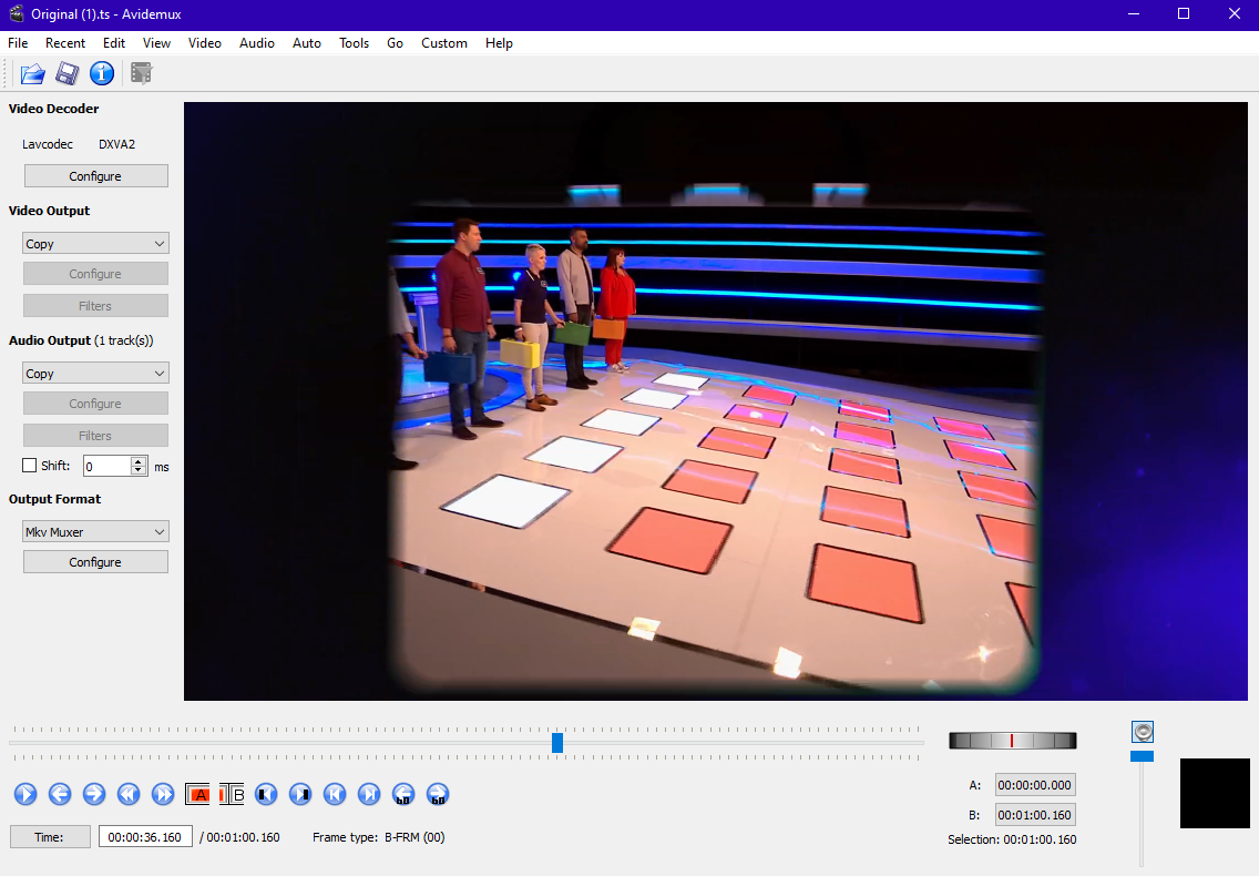

rbjtech 5344 Posted June 26, 2020 Posted June 26, 2020 Is it just this TV programme where it happens ? I've had a detailed look at both the .TS and the above .MP4 - frame by frame .. .MP4 - Has what looks like corrupt frames at these time markers - immediately after the 'Chase the Case' graphics shows 0.662 - OK 0.695-0.828 - 5 Frames - Are basically letterbox'd .. 0.862 - Back to normal again. .TS - has identical weird frames after the graphic So in short - something on the original recording is causing your TV to 'panic' and probably attempt to resize itself perhaps ? Capture 1 -> Capture 3 show the sequence - this is your 'glitch' .. but I do not think it has anything to do with emby ...
