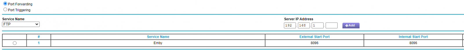

Misinthe 46 Posted June 10, 2020 Author Posted June 10, 2020 (edited) On 6/10/2020 at 5:46 PM, ebr said: Perhaps something in your configuration changed. If you go through that troubleshooting, exactly where does it fail? Which troubleshooting are you referring to? The Connectivity page? It fails at trying to reach the WAN IP from a web browser, it says it can't be reached. I double checked my Port Forwarding and my Firewall. Edited June 25, 2020 by Misinthe Removed image with sensitive info

Pankookis 10 Posted June 11, 2020 Posted June 11, 2020 (edited) 17 hours ago, Misinthe said: Which troubleshooting are you referring to? The Connectivity page? It fails at trying to reach the WAN IP from a web browser, it says it can't be reached. I double checked my Port Forwarding and my Firewall. Might want to delete the IP as anyone that has it can now connect to your server... Edited June 11, 2020 by ebr Removed image with sensitive info 1
Zodler 18 Posted June 11, 2020 Posted June 11, 2020 (edited) Yep, you definitely should delete that. I confirm. You can access it and you have no password! That's like the first thing administrators should say! Edited June 11, 2020 by Zodler
