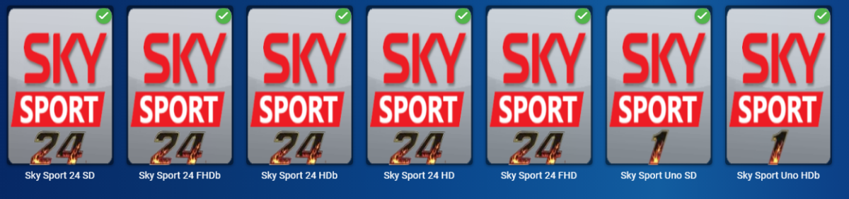

TJSNHS04 9 Posted December 12, 2020 Posted December 12, 2020 Hi I have the premium and I wanted to understand why it no longer loads all live TV channels, emby 5.3 did it before do not ask me to send records that I do not send anything
Carlo 4561 Posted December 12, 2020 Posted December 12, 2020 Hi, sorry can't help you without the logs to look at. However you can look at them for any errors if you're not willing to supply them for support. What you can see straight away is a raw mp3 file that needs lots of work as it's had duplicate channels. You have 3 each of Rai 1, Rai 2, Rai 3. In this case it looks like Emby is selecting the last entry of each channel.
TJSNHS04 9 Posted December 12, 2020 Posted December 12, 2020 (edited) this and before the update to 5.3 worked perfectly and nothing has changed except the logos. the register contains personal information sorry. Edited December 12, 2020 by TJSNHS04
TJSNHS04 9 Posted December 12, 2020 Posted December 12, 2020 (edited) #EX this works #EXTINF:-1 tvg-id="Rai 1 FHD HEVC" tvg-name="Rai 1 FHD HEVC" tvg-logo=" group-title="Top Italia",Rai 1 FHD HEVC Not works #EXTINF:-1 tvg-id="Rai 1" tvg-name="Rai 1 Full HD" tvg-logo="" group-title="Top Italia",Rai 1 Full HD what changed from the previous version as it used to work without having to rewrite the tags Edited December 12, 2020 by TJSNHS04
Carlo 4561 Posted December 12, 2020 Posted December 12, 2020 Are you sure it worked with the previous version with the same tvg-id? Is it possible your provider changed the m3u file?
TJSNHS04 9 Posted December 12, 2020 Posted December 12, 2020 (edited) the m3u file as I said has not been touched nothing has changed except the logos, the m3u file is not a link mha file in the hdd. the m3u file is always the one in the case I change only the links channels the rest always the same in the previous version this did not happen as in the photo above previous post I forgot this and only one of the problems with 5.3 there are others that did not happen before Edited December 12, 2020 by TJSNHS04
Carlo 4561 Posted December 12, 2020 Posted December 12, 2020 I honestly don't know if anything changed but if it did I'd expect a lot of people with problems first with the beta releases and then the normal release version. But the tvd-id should be unique or removed as it's optional.
TJSNHS04 9 Posted December 13, 2020 Posted December 13, 2020 (edited) Another problem the tv guide by removing the tvg-id = does not work, the strm files are not played on the android tv app, while on the android app yes, emby on kodi idem does not see the strm files or puts them where he wants and if there are not reproduces them while they used to work. Another problem, the logos as you can see in the previous post in poster format were correct now they are lengthened ....... i have to go on you have big problems i had with emby 5.3 this happened after the update to 5.3. I don't doubt that there are others Edited December 13, 2020 by TJSNHS04
Carlo 4561 Posted December 13, 2020 Posted December 13, 2020 It will work with the tvg-id but you have to manually map the channels. Personally, I'd leave them in the file but would get rid of your dupe channels. I personally only want the highest quality channel. I do the same thing for my hardware tuners and eliminate the SD channels that have HD versions.
