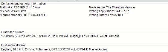

Swynol 375 Posted June 8, 2020 Author Posted June 8, 2020 Media Info and Emby identify it as DTS HD MA and another file it is also doing it with
