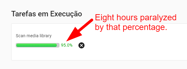

Guest Posted June 3, 2020 Posted June 3, 2020 (edited) I searched the forum and found nothing, but I was sure that I would find several topics with the same problem. Yesterday, two friends reported that all the data in their bibliographies had disappeared and when checking my Emby, everything seemed normal, so I understood that it would be a problem caused by them and I did not give much importance. It turns out that at the end of yesterday night, already at dawn, some customers reported that they were unable to reproduce any video and that the images had all disappeared. Upon analyzing, I found that in fact most of the data is gone. So I did a new general screening of the libraries and confirmed that Emby did the process from 0% to 94% in a maximum of one hour of time, but now, eight hours later, the advance was from 94% to 94.6% only, that is, this is absolutely abnormal. I thought to send the log files, but I do not know how valid it is, since the last log files sent have not received attention and I still have no answer, as is the case with high memory consumption. I would like to receive some concrete answer for this problem to be solved. Thank you. PS: I set up for Emby to save the nfos and arts in the media folders, which are on the google drive. Edited June 3, 2020 by CarlosLima

Guest Posted June 4, 2020 Posted June 4, 2020 (edited) Since yesterday, more than 20 hours after the start, tracking has increased from 94% to just 95% and this creates great stress with customers, with numerous complaints. If the arts and nfos are in the media folders, why does Emby need such an absurd time to restore the data? Shouldn't it be easier to have all the data already? And what about backup, what is it for anyway? It is really necessary for developers to find a way to make this more practical and less stressful, especially much faster. If the files are stored in the media folders and if there is a backup, the replacement of all lost data, due to system failure, shouldn't be something resolved in a matter of a few minutes ?? With the floor, the developers, please. Edited June 4, 2020 by CarlosLima

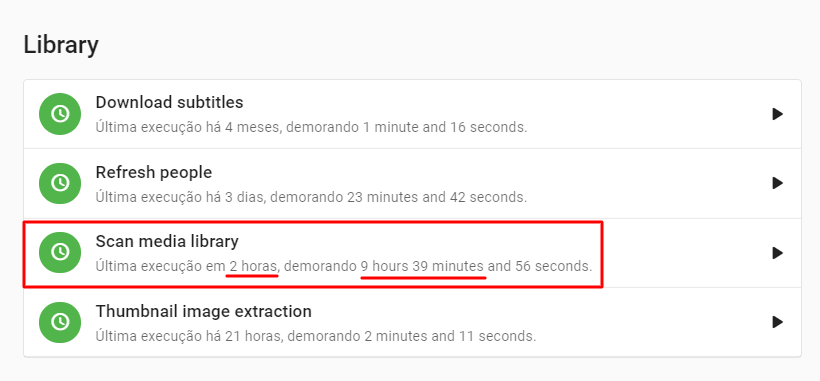

Guest Posted June 4, 2020 Posted June 4, 2020 (edited) Even though he turned off all the trackers, it took Emby a long time, close to ten hours to reprocess the libraries, even with all the local metadata. Is it possible to avoid this system failure so that the metadata does not disappear? And in the case of a new failure, what is the most appropriate action we can take to recover the metadata in less time? The backup, what is his function to assist in this? What about manually copying any folder or file so that it is superimposed in situations like this? Is there a folder or file that we can keep in copy to replace the file in use in case this failure occurs again? Edited June 4, 2020 by CarlosLima

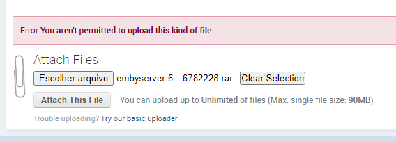

Guest Posted June 4, 2020 Posted June 4, 2020 Try zipping it up. Finally I managed to compress the log, which was only 5,199 KB in size, but when trying to send ...
Guest Posted June 4, 2020 Posted June 4, 2020 (edited) It seems that the Emby system does not receive a .RAR file, so I tried the .ZIP format ... embyserver-63726782228.zip Edited June 4, 2020 by CarlosLima

Guest Posted June 13, 2020 Posted June 13, 2020 On 6/11/2020 at 3:51 PM, Luke said: Are you still having an issue with this? It took more than a week of hard work every day before I had metadata again. The arts are now complete, but the synopses are still many in another language and I'm still editing everything manually. The important thing is to find a way for this type of failure not to occur or that we have a less audible way to replace everything in case of another disaster, as it is quite frustrating to have to redo all the work. Should the backup system be efficient and solve this, by the way, what is the use of emby backup for? Thank you
