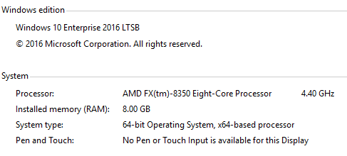

T_Tronix 16 Posted May 22, 2020 Posted May 22, 2020 (edited) Today I tried to run a 2160p mkv file on the following devices (not all at once but once on each device): TCL 4 series 55" with built-in Roku 4K using cat6 direct ethernet connection Nvidia Shield connected with Cat5 to a giga switch Trednet TEG-S80G connected with cat6 to router. FireTV 4K stick via wifi Router: AX88U with latest Asuswrt-Merlin Emby Windows server running on: I am using link aggregation (1GB X 2 connections) via Cat6 wires direct to router. All 3 devices buffered at some point. Edited May 22, 2020 by T_Tronix

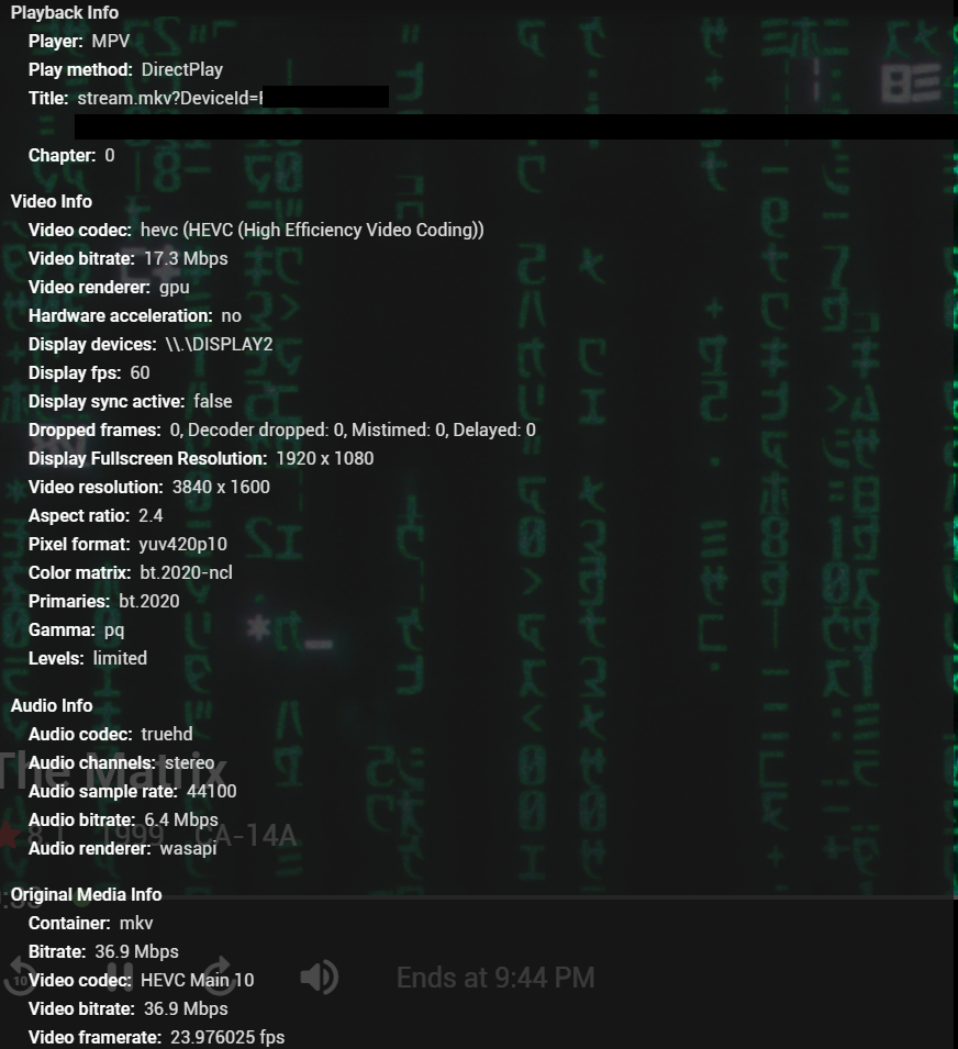

T_Tronix 16 Posted May 22, 2020 Author Posted May 22, 2020 (edited) So running this via Emby Theater on another Windows10 device does not buffer. Here are the stats for nerd from that PC: Edited May 22, 2020 by T_Tronix
