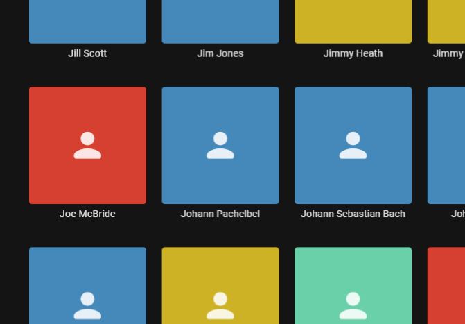

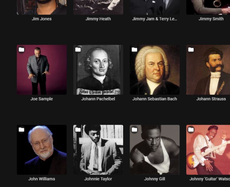

EZEd 60 Posted May 20, 2020 Author Posted May 20, 2020 (edited) I've stumbled across similar issues after removing and re-adding music. I know the artist is missing but do the Albums for Joe Sample appear? In some cases I've had to go to an album (for a missing artist) and select Identify, and re-add it that way to get the artist to appear. If the albums do appear you might notice that the artist name is listed under the album name but it isn't a clickable link, like it should be. Well sort of, as indicated in images 5,6 & 7 above. The artist does appear in the Folder view. But it is artwork only. None of the actual song files show. Originally when I checked the album.nfo files for these folders the songs were not listed there either. I manually edited the album.nfo files to list the songs within each. On subsequent refreshes, Emby would simply overwrite my edits back to no song files. I eventually write protected the album.nfo files to stop that from happening. So now the album.nfo files still have my edits intact but Emby still does not acknowledge that the actual MP3 files for the folders actually exist. I just need some way to force Emby to recognize the actual MP3 files. The artwork is recognized but the MP3 song files is not. Post edit: re-identify is likely not going to work in this case because I have the scrapers turned off. But even when I had the scrapers turned on. It still would not recognize the song files for this artist. Again creation of duplicate entries is the reason I turned the scrapers off. Everything else works just fine as near as I can tell except for this one case. I haven't thoroughly scrubbed the library to see who else might be missing but this one is for sure and I can't find a cure. I'd like to have a cure before I go looking for more desease. Edited May 20, 2020 by EZEd
