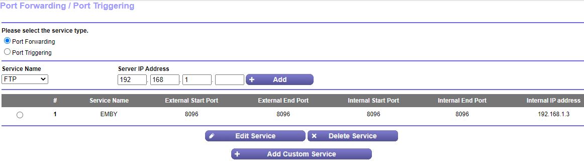

BobT 2 Posted May 22, 2020 Author Posted May 22, 2020 RBJTECH: Modem (owned by ISP) Cisco DPC3000 Router (owned by me) Netgear WNDR4700 pics attached of router port forwarding page and address reservation. I have no idea what the difference is. ADDRESS RESERVATION
rbjtech 5337 Posted May 22, 2020 Posted May 22, 2020 (edited) ok - so you have a Cisco Cable Modem > Netgear WNDR4700 router - good. The port forwarding looks good from what I can see. Can you access emby fine locally with a browser from a different PC on the same network ? ie using http://192.168.1.3:8096 from say a PC with an IP of 192.168.1.x ? Edited May 22, 2020 by rbjtech
