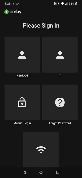

EatPrilosec 22 Posted March 26, 2021 Author Posted March 26, 2021 (edited) Spoke too soon. When restoring the backup, the apostrophe truncates the rest of the name, see pic (user name was T'ler, (apostrophe not backtick (didn't try to restore a backtick backup))) Settings were fine, no password to test. Had orignal access to library. Edit: This post topic has changed like 4 times now, if I need to make a new post I can, with a backtick user Edited March 26, 2021 by NErdgOd56
Carlo 4561 Posted March 26, 2021 Posted March 26, 2021 I must admit I've never tested something like this. My Question to you would be do you really need the apostrophe in the user name? Isn't it a royal pain to enter on clients? I'm surely not discounting what you've found but just asking.
Luke 42203 Posted March 27, 2021 Posted March 27, 2021 Yea we'll take a look at this, but the most practical answer would be to not put a quote in the username.
EatPrilosec 22 Posted March 27, 2021 Author Posted March 27, 2021 (edited) On 3/26/2021 at 7:10 PM, cayars said: I must admit I've never tested something like this. My Question to you would be do you really need the apostrophe in the user name? Isn't it a royal pain to enter on clients? I'm surely not discounting what you've found but just asking. Yes, that is the most obvious solution, it's not a requirement or anything, just an inside joke, but it obviously indicates somethings not 100% solid in some parser. I'm by no means a security researcher, but it's gotta be some kinda mild threat-- other than being an (extremely mild, I'll admit) annoyance. Also some non-english origin names have apostrophes, De'Andre O'Connor, for example. If the problem was something like backslash or brackets, or pipes | , I'd not have brought it up at all 23 hours ago, Luke said: Yea we'll take a look at this, but the most practical answer would be to not put a quote in the username. I was just bringing it to y'all's attention. Due diligence sorta thing. By no means do I expect this to be considered high priority, or fixed (I had already removed the apstrophe, I started using it again to re-test at your and @cayars request) Edited March 28, 2021 by NErdgOd56 1
Luke 42203 Posted March 28, 2021 Posted March 28, 2021 Understood, and yes we'll look into it. Thanks for the info. 1
