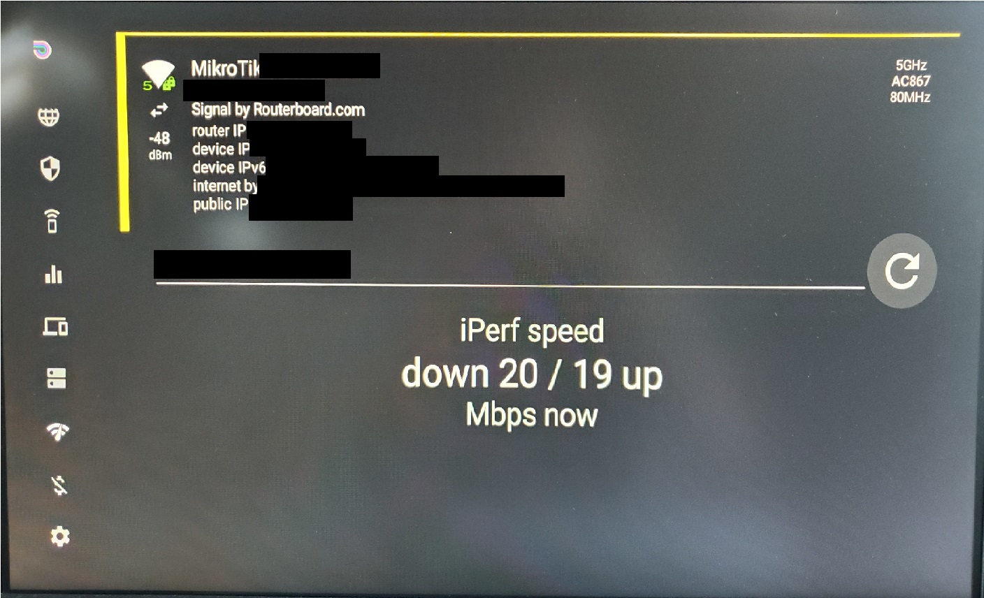

danergo 40 Posted May 13, 2020 Author Posted May 13, 2020 (edited) Original Media is 15.62Mbps. what happens when you force a transcode by lowering the bitrate settings in the client app? It plays fine around 1-3Mbps but I didn't buy FireTV Stick 4K for watching FHD videos with 1MBps bitrate.. what does your server dashboard say while you are playing something on the firestick? What do you mean by this? Dahsboard prints on firetv's player: xy's FireTV AndroidTv 1.7.92a Direct playing are you running your iperf tests from the firestick to your nas? From stick to nas, yes: Do you see something wrong? Edited May 13, 2020 by danergo

ebr 16338 Posted May 13, 2020 Posted May 13, 2020 Hi. Your app version is correct. I see your max bandwidth at 20Mb and, whenever the delivery goes over that (as shown in your graph) that causes a lag. One thing to try would be to go into the playback settings in the app and set the buffer value to "Small" and see if that makes a difference.
