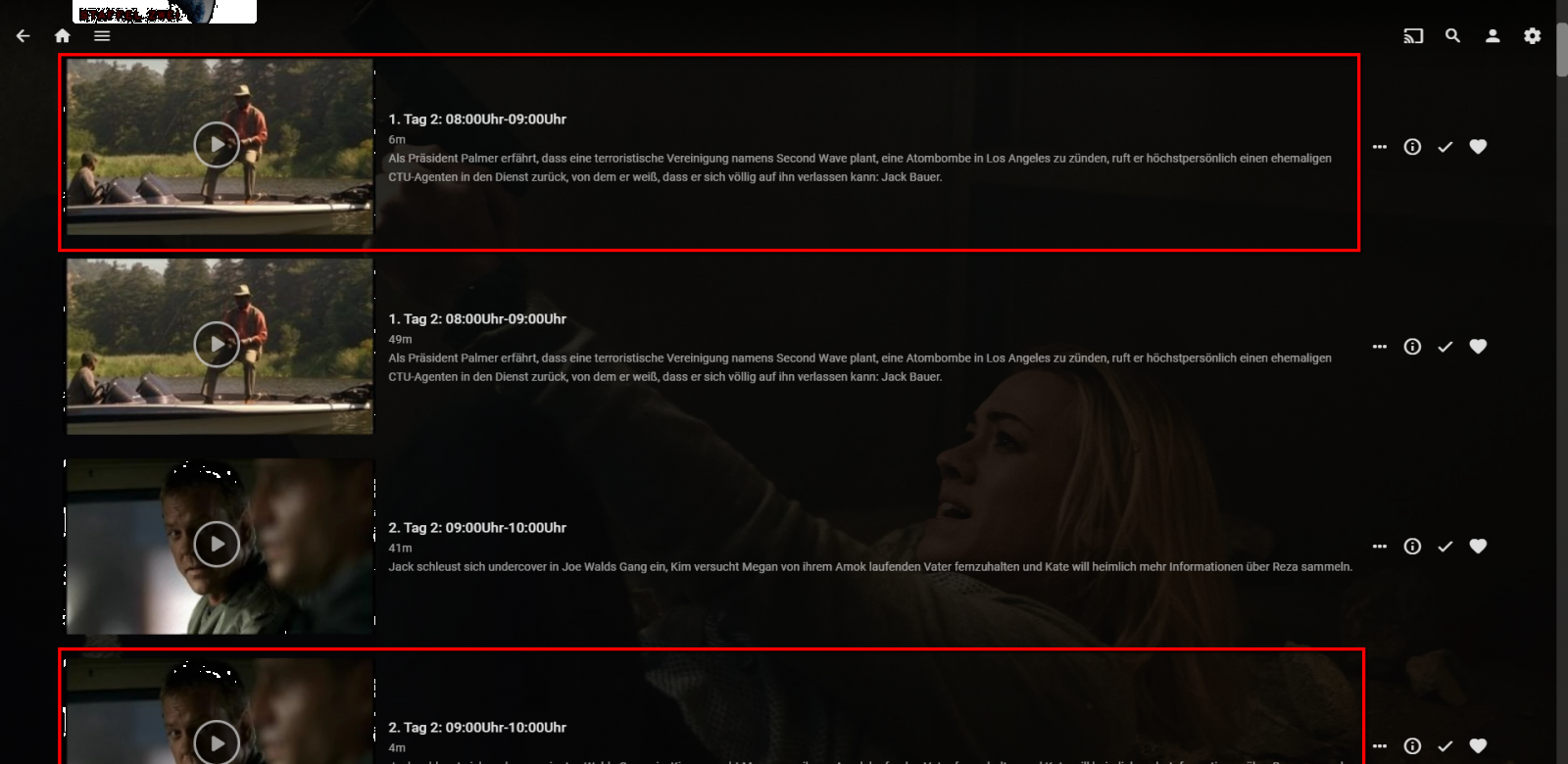

LiaraAlis 15 Posted May 12, 2020 Posted May 12, 2020 Hi together, I'm currently digitizing my dvds of the 24 series. I would like to add the deleted scenes to my library. For that I created a separate directory: In this directory I named the files like "24 Deleted Scenes S02E01.mp4". Now the episodes are only shown in season 2 as a second version (both version with the name "S02E01" so it is not possible to see the difference between both versions) and not listed under "Deleted Scenes" as I should like. I can split the versions and then the deleted scenes version is listed in "Deleted Scenes" and in "Season 2". Is there a way to remove these episodes from Season 2 so that these deleted scenes are only accessible via the Deleted Scenes folder? I also tried to disable the option "Merge series contents scattered over different directories automatically" but this has no effect, not even after a new library scan. Best regards,Alexander
Bigmack3000 108 Posted May 13, 2020 Posted May 13, 2020 I made the same mistake at first. It's because you're using the naming structure for television episodes. I then started naming deleted scenes as "Deleted Scene Season x Episode y" to get around it.
