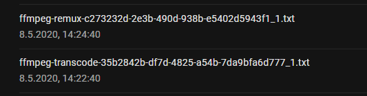

i also attached the remux log, and as sample a transcode log from same stream (working setting 1080p \ 8mbit)
may u guys have a idea ;)
ffmpeg-remux-c273232d-2e3b-490d-938b-e5402d5943f1_1.txt
ffmpeg-transcode-35b2842b-df7d-4825-a54b-7da9bfa6d777_1.txt
