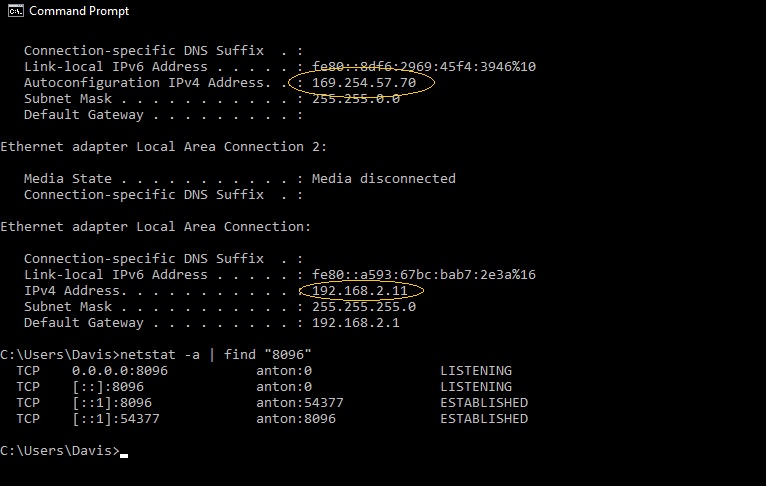

Guest Posted May 8, 2020 Posted May 8, 2020 (edited) Howdy, so before I saw your message, I reset my router just to see if it would do anything, but yes based on your most recent reply I am honestly not sure why i was / am running both hah, I just am not very tech savvy and just did not realize what I was doing. I still kind of dont unfortunately heh. Okie so just ran the same two command prompts you asked me to a while back and there is the screen cap! So now it seems to have changed from 192.168.2.14 to 192.168.2.11 And to proceed, I just input the second one, 192.168.2.11 into the empty field in network settings on Emby where it wants to bind to a local network address, then it should work? I will go ahead and do that right now! Edit: No dice I tried entering both of those addresses in the bind to local network field, as well as entering them into the Theater window, along with server resets in between and still having the wireless thing disabled since you mentioned to disable it again, and no access for me. I am doing something wrong probably but I have been awake for close to 38 hours, definitely not my finest moment for learning new tech stuff. Edited May 8, 2020 by Guest
rbjtech 5335 Posted May 8, 2020 Posted May 8, 2020 You just need the one address - 192.168.2.11 Ignore the 169 address, that is basically 'no address'. You should be able to 'ping' yourself and the gateway. So try these ping 192.168.2.11 and ping 192.168.2.1 if you get 'replies' from both of these, then 192.168.2.11 is definitely your IP address and this (and only this) should be what you need to put in the 'bind' config for emby. For kicks, in the 'LAN Networks' section above the bind - put in 192.168.2.0/24 and restart emby. On the clients, just use 192.168.2.11 as the server with port 8096. use a browser to start with, forcing http - ie http:\\192.168.2.11:8096 If that doesn't work - then I'm really out of ideas as 'something' is listening on the correct port 8096 on your machine as shown by your netstat results above ..

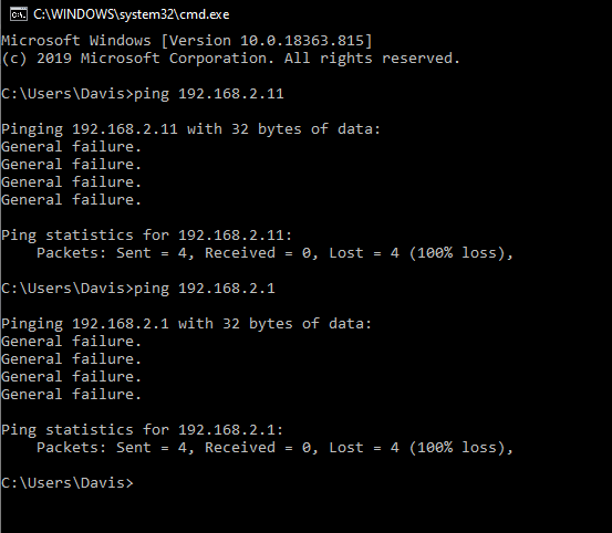

Guest Posted May 9, 2020 Posted May 9, 2020 Alright, eighteen hours of sleep later and I am back at it, albeit with seemingly sad results:It doesn't appear that I am off to a good start today! A little too many general failures for someone like me to be bombarded with before 7:00 am
rbjtech 5335 Posted May 9, 2020 Posted May 9, 2020 Oh dear .. So if the machine can't ping itself or local gateway - then there is something very wrong with basic networking on that device..

Guest Posted May 9, 2020 Posted May 9, 2020 Did you ever try http://localhost:8096 ? Unfortunately yes, that was one of the first things I tried. But I just turned on an old laptop and installed the server, and voila, my local address shows up instantly, with theater playback working to perfection, doing exactly what I needed it to do: playback films in their native resolution and bitrate or whatever and not tearing my CPU to shreds -- and by extension, not have my films constantly buffer every two minutes despite transcoding at a lousy 4mbps ! As shitty as it is that I can't use Emby on the laptop that I use everyday due to its networking problems, I am relieved to know that it's not Emby's fault at all, so thanks to @@rbjtech for holding my hand through this baloney and getting to the bottom of it all! I was this close to just bailing, and using something else. I will be sure to setup a server on whatever computer I end up building in the future, and for now I will just have to repurpose this absolutely f***ed up other computer into a temporary server for the time being! Thanks everyone, means a lot!
rbjtech 5335 Posted May 9, 2020 Posted May 9, 2020 A fresh OS rebuild is probably best - but you could try the commands below (right click on CMD before you hit enter and 'Run As Administrator) as they need elevation :- Reset WINSOCK entries to installation defaults: netsh winsock reset catalog Reset TCP/IP stack to installation defaults: netsh int ip reset reset.log Reset Firewall to installation defaults: netsh advfirewall reset All the best.
