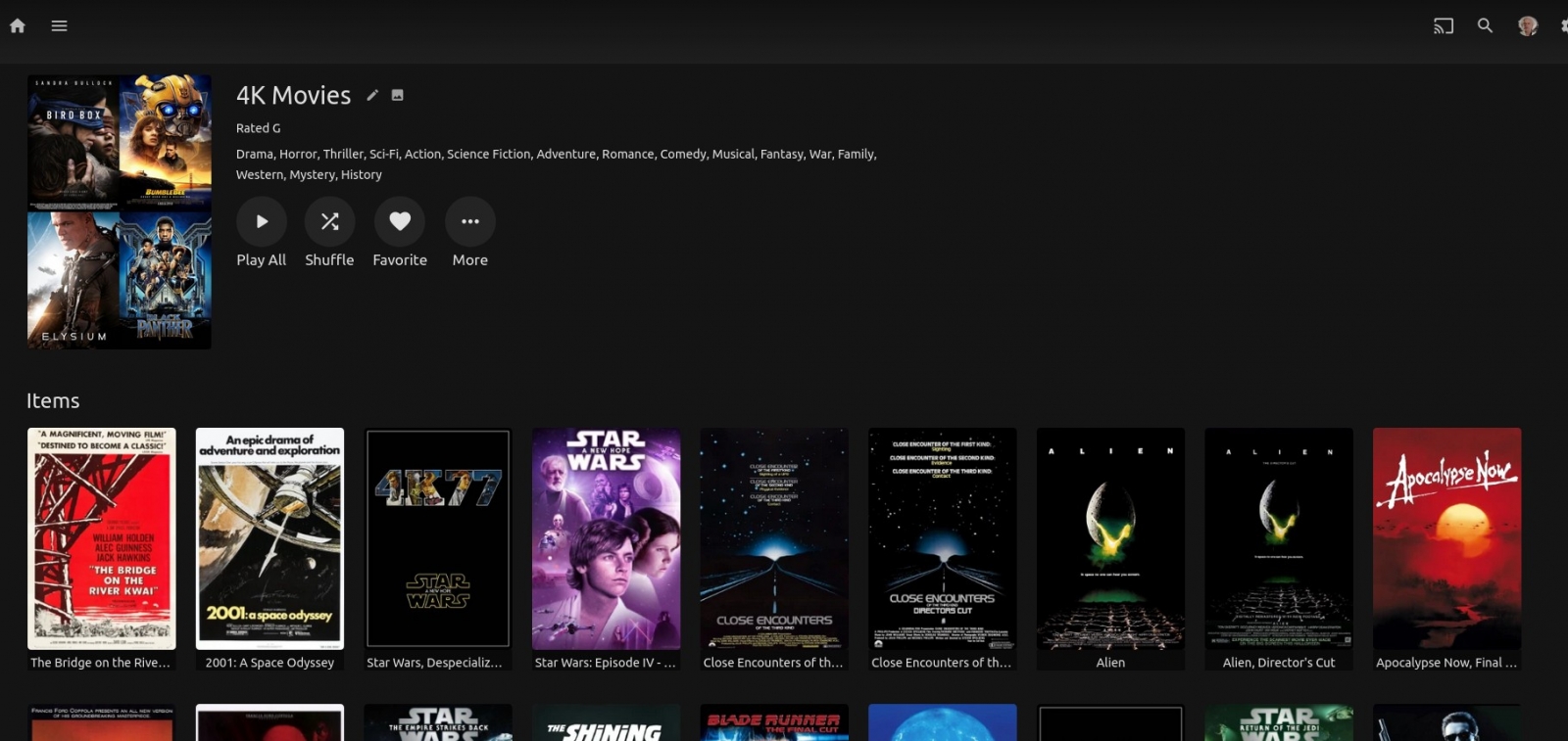

nanouk76 1 Posted May 8, 2020 Author Posted May 8, 2020 (edited) Hi, thanks for your time. emby server won't replace your artwork Sorry to say but it did. This is how I noticed something was not really right. I created a collection of 4k movies. Then I noticed that there were still a few posters that I had not changed (I like to have the original movie poster whenever possible for the primary artwork). So once that was done I was a happy camper. But then, a few days later, I was surprised to see that after the scheduled scanning of library files (the default one takes place around midnight IIRC) some posters had reverted back to the "default" one. So thinking this was a random "glitch" of the system I went about changing the poster art again. Took me less time since I had all the art ready but still very annoying. Then again after another scheduled scan, the same movie posters had reverted back to the default one. That crazy thing happened a couple of times so I ended up disabling the scheduled library scan because it is just unacceptable not to be able to control things. What is so weird is that the customized artwork is there in the movie folder so why would the scanning not use that ? Edit : manually scanning library files does not affect the artwork Edited May 8, 2020 by nanouk76

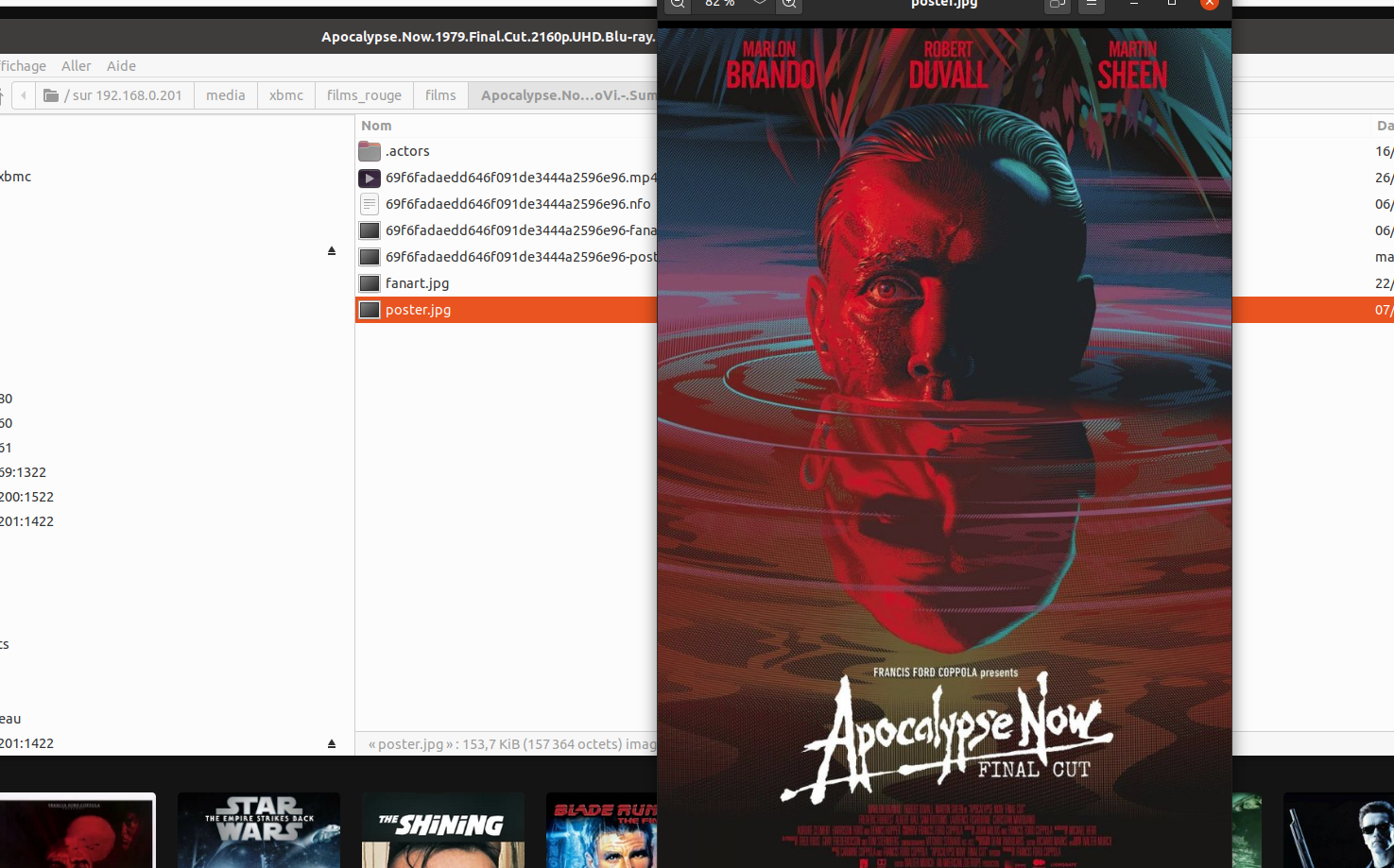

nanouk76 1 Posted May 13, 2020 Author Posted May 13, 2020 Hi Luke, that thing happened again... but I think I understand the issue now. The thing is I have manually scanned the library files a couple of times without noticing any change so I can't pinpoint when the substitution happened. Couple of screenshots to prove it: Screenshot one : the poster for Apocalypse Now Final Cut has been changed to another atwork. Screenshot 2 : As you can see the poster that I chose is present in the movie folder under the default name poster.jpg but since I also use Kodi, there is another poster named 69f6fadaedd646f091de3444a2596e96-poster.jpg as per the Kodi naming convention. I know I can change the latter poster to be the one I want but I would think that Emby would pick-up the file poster.jpg before the other one. Do I have to change the artwork or is there a way to make Emby display poster.jpg only? Any help would be much appreciated. TIA Cheers

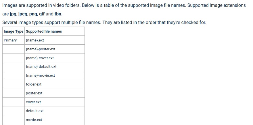

Happy2Play 9814 Posted May 13, 2020 Posted May 13, 2020 I wouldn't think the 69f6fadaedd646f091de3444a2596e96-poster.jpg (unless it is assume item name) would take priority over poster.jpg but there is a order of precedence when you have multiple images. Not positive if the wiki is in actual order of precedence though, see Video images section. https://support.emby.media/support/solutions/articles/44001159102-movie-naming
nanouk76 1 Posted May 13, 2020 Author Posted May 13, 2020 I wouldn't think the 69f6fadaedd646f091de3444a2596e96-poster.jpg (unless it is assume item name) would take priority over poster.jpg but there is a order of precedence when you have multiple images. Not positive if the wiki is in actual order of precedence though, see Video images section. https://support.emby.media/support/solutions/articles/44001159102-movie-naming I guess I should have read the wiki... 69f6fadaedd646f091de3444a2596e96-poster.jpg took priority over poster.jpg as per this : Thanks for clearing the matter out. I know what I have to do now. Thanks a bunch. Cheers 1
