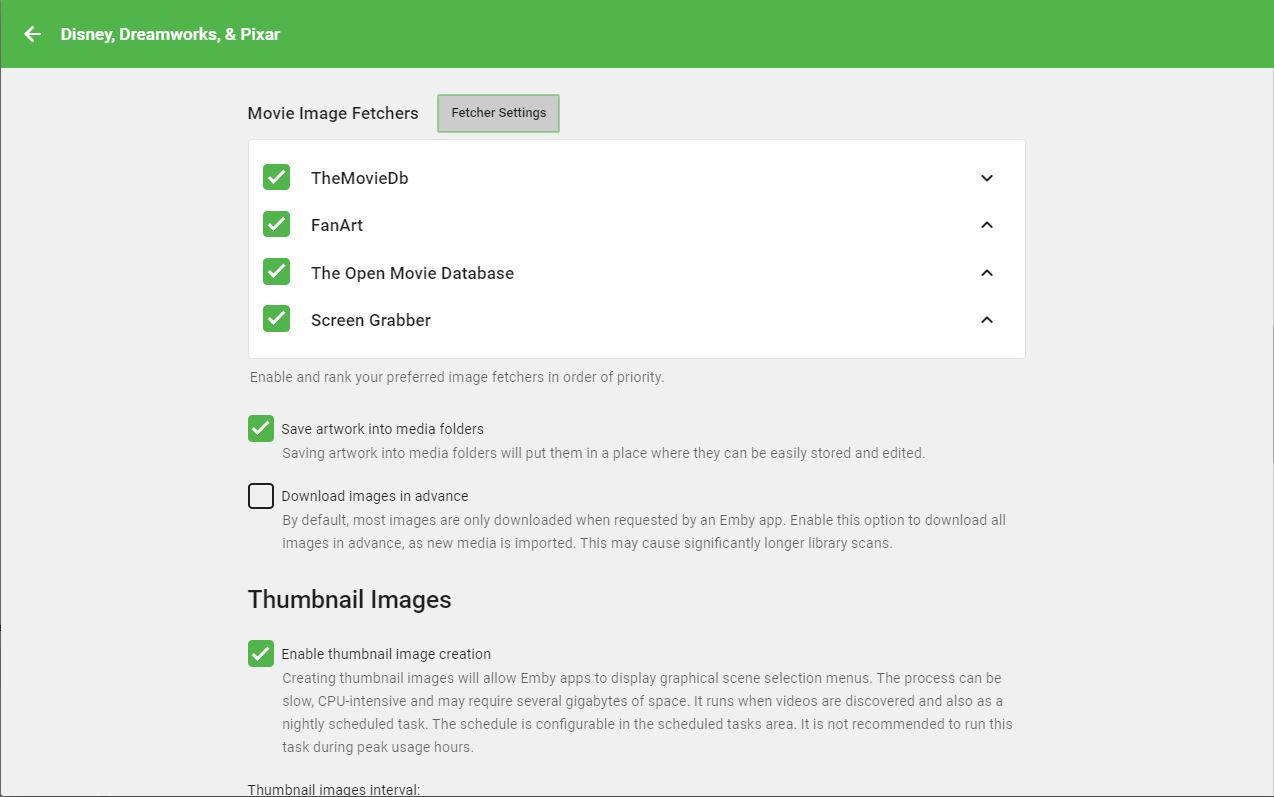

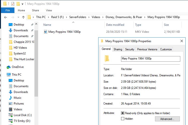

nairnmonster 6 Posted May 4, 2020 Author Posted May 4, 2020 Ok, so changed all permissions to the standard, users, system, admin etc. This didn't allow changes. I used Mary Poppins as a test, I removed the folder containing both the movie, meta data and images. Done a library scan, then re-added. It populated with the old image and still would not allow me to change. So I again removed the whole movie folder, deleted all meta & imaged and added as a completely new movie. After scan it showed with a whole new poster but I was able to change this from within Emby. However... I have the below set but nothing is downloading into the folder as expected. What have I missed or done wrong? Thanks as always Steve
nairnmonster 6 Posted May 4, 2020 Author Posted May 4, 2020 So... playing about more, if there is any images in the folder Emby will not make any changes or allow new files to be downloaded. I even manually changed a folder image and Emby would not allow it to be imported or pick it up during the scan. Only when I delete this, re-scan the folder it would then download new images and allow for changes to be made. But does not store the images in the movie folder. So that does make me think Emby is not getting permissions to the storage but I can't see how this is permission based now. I even for testing added "Everyone" with full control and still no change.
nairnmonster 6 Posted May 4, 2020 Author Posted May 4, 2020 Ok, make a whole new directory on another network share to simulate the current one. But only permissions was "Everyone" set with full control. Added a single movie, it downloaded all meta and images and allows for image change. So, it's clearly a permissions issues on the main drive. I'm going to remove all rights from that drive and start completely from scratch. I will win this battle!
Solution nairnmonster 6 Posted May 4, 2020 Author Solution Posted May 4, 2020 (edited) So I couldn't understand why it was using the user permissions and not the administator rights. Found the below, so turns out on server 2016 it starts emby as a user and not administrator. Edited the startup so that runs as admin... bang and the dirt is gone! https://emby.media/community/index.php?/topic/37634-permission-issue-windows-10/ Thanks so much for you help, you defo put me on the right direction with permisisons. I wouldn't have found that without your help! Edited May 4, 2020 by nairnmonster 1
