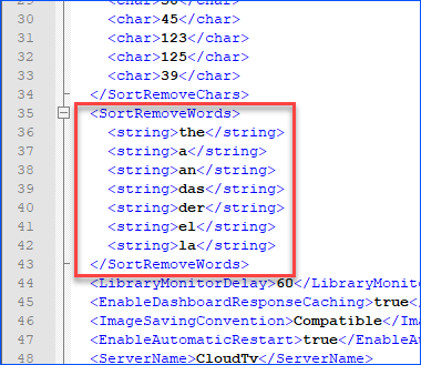

You would have to modify your system.xml as these are coded SortRemoveWords.  In theory these should be configurable via the UI.
<SortRemoveWords>
    <string>the</string>
    <string>a</string>
    <string>an</string>
    <string>das</string>
    <string>der</string>
    <string>el</string>
    <string>la</string>
  </SortRemoveWords>

I found the area in the system.xml, but I don't know what to do with it.
Thank you

Just remove the strings from the system.xml and do a library scan.  Should apply to all items.
