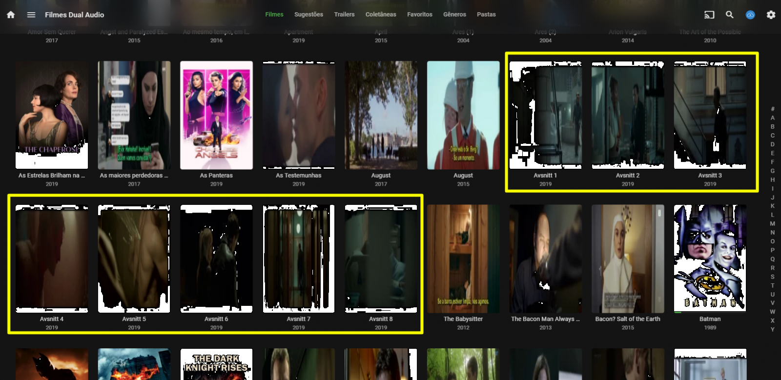

Guest Posted April 30, 2020 Posted April 30, 2020 Hi, When creating a new Movies library, with about 300 individual folders, all stored in a single folder, I noticed a serious mistake by Emby. It turns out that Emby created the library with totally crazy items, including hundreds of things that are not in the folder. As far as I could understand, these marked items are series episodes that are in another folder, which has nothing to do with the folder indicated in the library, for tracking, that is, Emby went to get data from another folder and made the library something totally crazy. I removed the entire library, rescanned it and redid the same collection and the result was the same. I ask for attention with some priority, as this is something very harmful. Thank you

dansblackcat 37 Posted April 30, 2020 Posted April 30, 2020 (edited) Avsnitt is Swedish for Episode. Maybe it's picking up an Avatar tv series of some kind? I'd try renaming the folder to Avatar (or as suggested above Avatar (2008)) and then clear everything out of the folder, leaving just one of the movie files? Then run a full scan and allow it to complete. Edited April 30, 2020 by dansblackcat

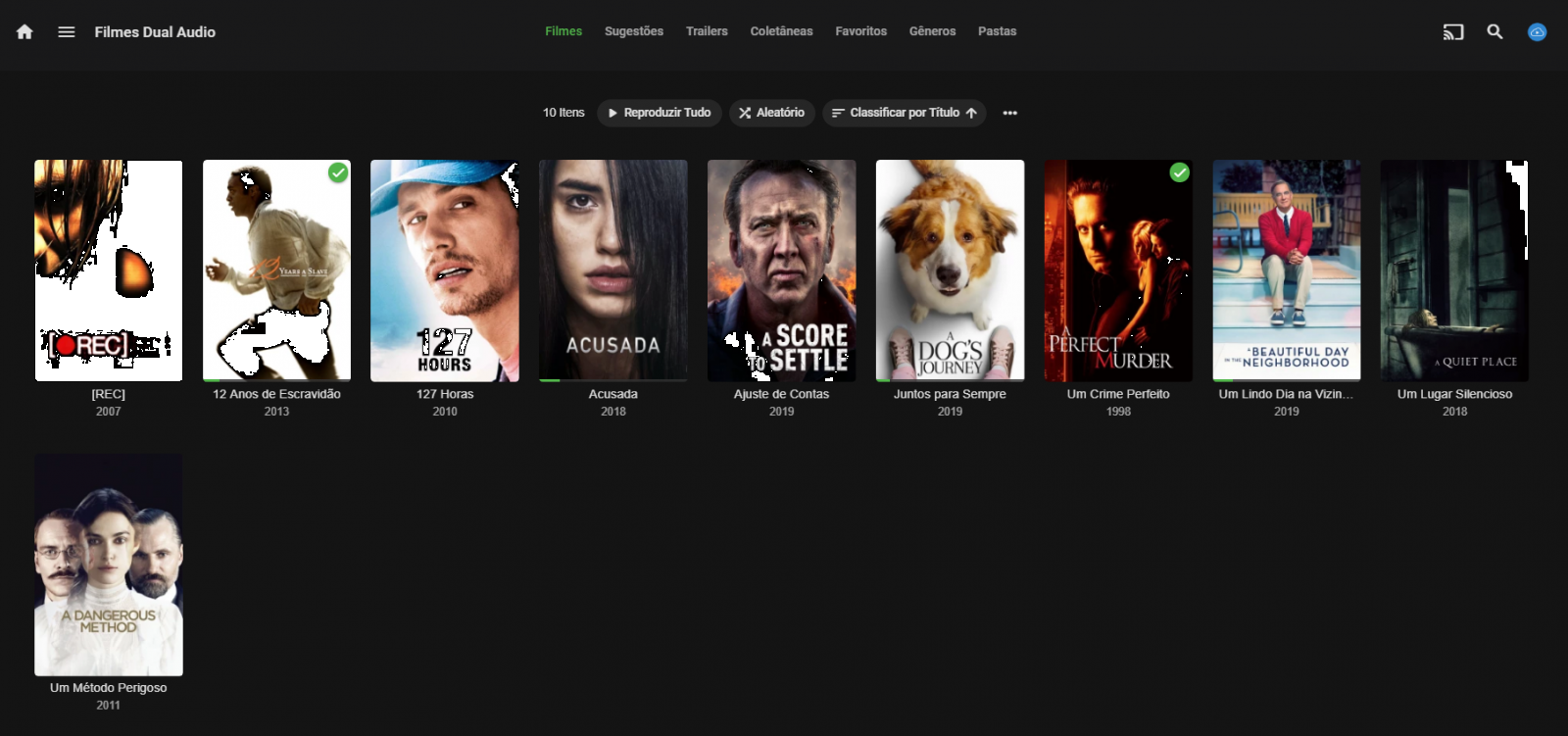

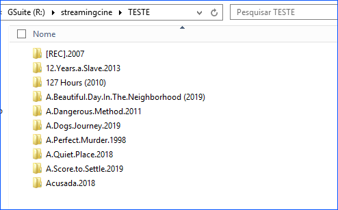

Guest Posted April 30, 2020 Posted April 30, 2020 Well, about the new tests I did. 1. I created a new folder, TEST 2. In the TEST folder I added copies of ten movie folders in multi versions 3. Of the ten folders, I renamed only two folders and did not rename any files within the folders 4. The folders I've always used and never had a problem, have the following format:A.Quite.Place.2018 [using dots between words] 5. As tests, to understand how Emby treats each of the formats, I renamed the 2 folders as follows:- 127 Hours (2010) [without dots and year in parentheses]- A.Beautiful.Day.In.The.Neighborhood (2019) [keeping the dots between words and the year in parentheses] 6. I kept the other eight folders in the usual format, as per item # 4 above. So I created a new library pointing to the TEST folder and Emby did the perfect scan, without adding that crazy films that refer to a Nordic series folder that I have separate and everything is perfect too. Thus, it is proven that the format I use for films with multiple versions can indeed have this format (Avatar.2012) and within it, the film in the format Avatar.2012 - 720p.mp4 and Avatar.2012 - 1080p.mp4 In short, the mystery remains that Emby added these films (post # 1) that are actually episodes of Nordic series that are in another folder (Nordic Series) and with that library everything is perfect too. So I think I have no alternative but to remake the Multi Versions Movies library.

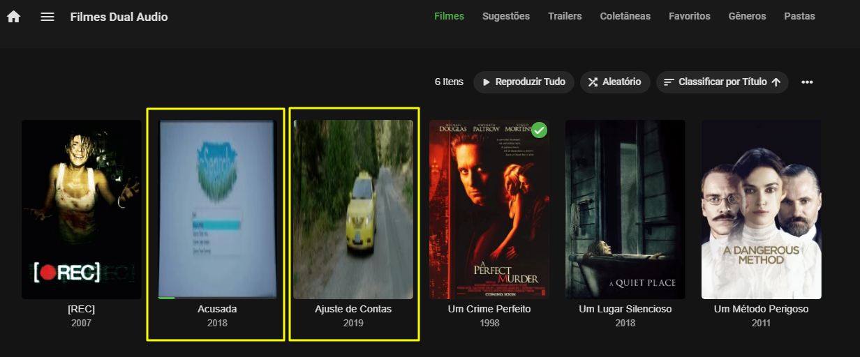

Guest Posted April 30, 2020 Posted April 30, 2020 Now I have done new tests. 1. Delete the test library he had created and Emby did a new scan, showing that the library was indeed deleted. 2. I deleted from the TEST folder the 2 movie folders that I had renamed, leaving only six folders, with the format I always used (Avatar.2012) 3. I created the library again pointing to the TEST folder. 4. As you can see in the image, Emby correctly identified the 6 films, but was unable to download the poster for two films (which in the first test downloaded the posters for these same films). 5. This makes me believe that if the official library is re-created with 600 films, Emby will not be able to download the posters for many other films, not to mention the mistake of post # 1, which I have not yet identified the reason for adding data that has nothing to do with the library folder. I ask for help to solve this problem. Thank you
