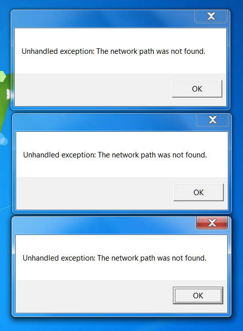

hansolo77 11 Posted July 6, 2014 Author Posted July 6, 2014 Nope, didn't move anything... i even tried a hard/cold reboot of my computer and it still does it. According to the Dashboard, I'm running 3.0.5289.18702 This is the desktop error I get. Pretty generic. I will tell you this though, the Dashboard remains available until I click the OK button on the error, then the Server closes down and the Dashboard becomes unable to connect. While inside MB3 Classic, an error pops up while navigating about the program being an Invalid Application. I can't get a screen capture of it, for some reason I just get a black image, both windowed and fullscreen. This is the link to my error log though: https://www.dropbox.com/s/qnrt98tdz4yxiiz/MBClassic-572014ff8c30ca44a74b32a30145aab0de780b.log

Luke 42183 Posted July 6, 2014 Posted July 6, 2014 Well for one, you've customized the server's cache path but now that path is unavailable. That's definitely going to cause problems. if this is going to happen normally then you're better off not customizing the path.

hansolo77 11 Posted July 6, 2014 Author Posted July 6, 2014 (edited) I never changed the server cache path.. only the IBN path. I'll recheck it to make sure. Ok, maybe I did, I show it as in my network's server path... what should the default path be? Edited July 6, 2014 by hansolo77
