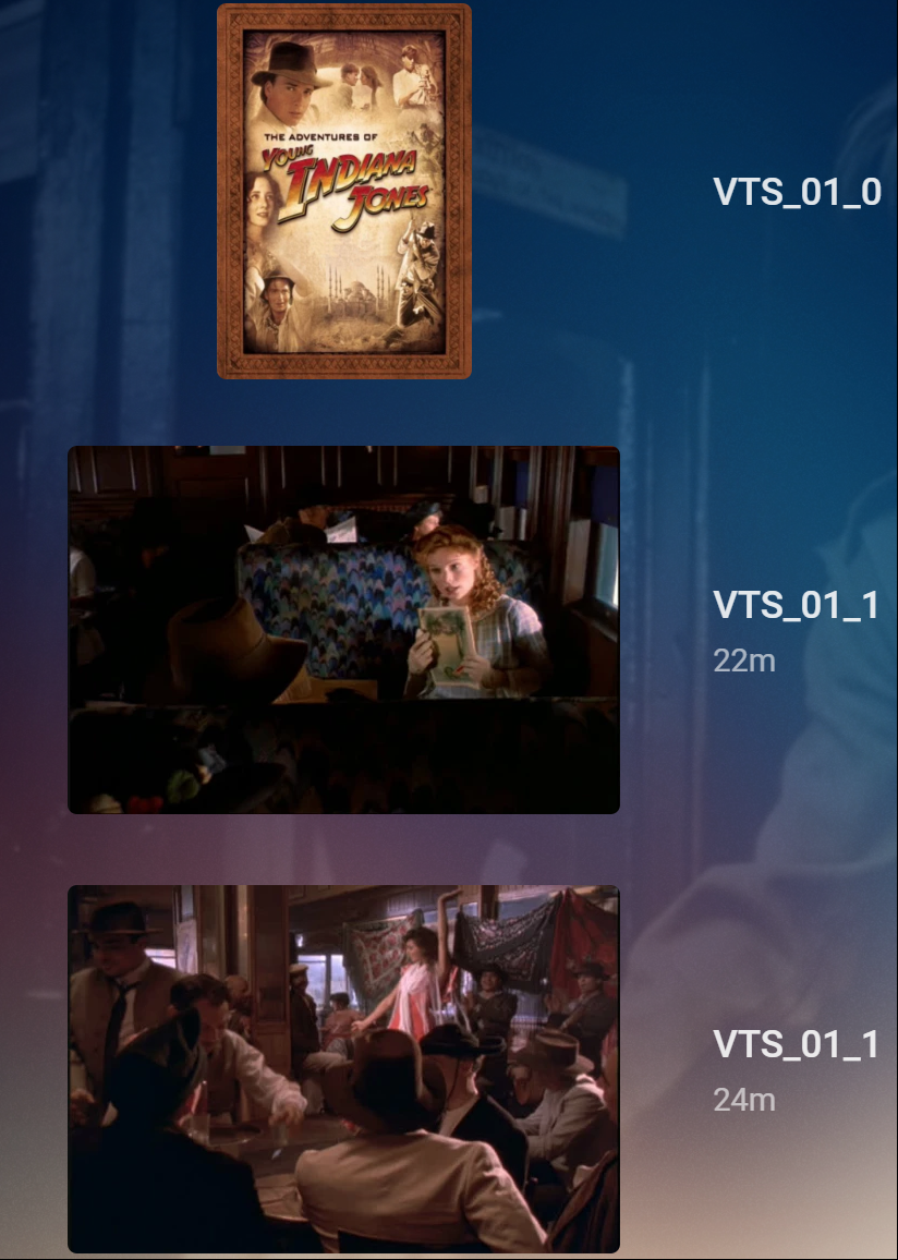

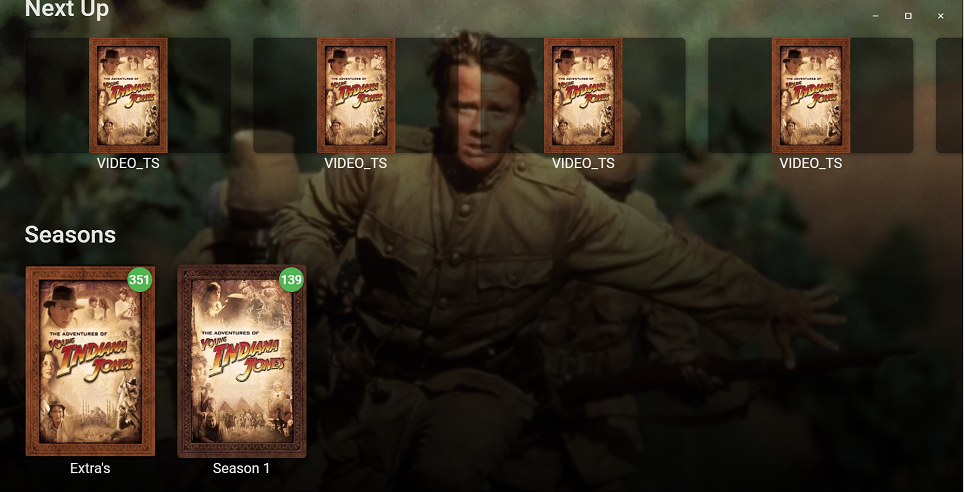

CSUCMB19 0 Posted April 27, 2020 Posted April 27, 2020 (edited) Hi, After the most recent server update (Emby Server for Windows - 4.4.2.0), I noticed that video_ts files listed under the TV Show format are no longer displaying correctly. I use emby theater (3.0.11) for windows. The TV show library is listing all of the video_ts folders as files and also listing all subsequent DVD files (VTS_01_0,VTS_01_1, VTS_01_2, ...) as objects in the library. The first shows the folder view in the library: The other image shows the individual files displaying: I have used the following file naming convention on all shows: TV Shows 1 \ The adventures of Young Indiana Jones \ Season 1 \ s01e01 [TITLE] TV Shows 1 \ The adventures of Young Indiana Jones \ Season 1 \ s01e02 [TITLE] I do not see an issue with movie files in the Video_ts format. I do not see an issue with other file formats or folders. It appears to only pertain to video_ts files in libraries using the TV show format. I have tried re-creating the libraries in emby server, and loading individual shows as folders in the library, and have the same display issues. Has anyone else observed this behavior or know a possible fix? Thank you in advance for the help, I really love the program! Edited April 27, 2020 by CSUCMB19

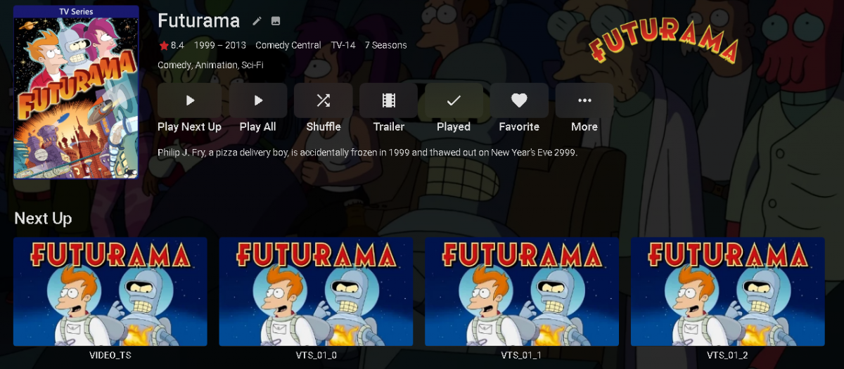

TheGrimKeeper 30 Posted July 28, 2020 Posted July 28, 2020 I decided to open a thread over here since the one I tried to hijack is in the Linux forum, and I'm running Windows. Anyway, following up on this ticket: I did a fresh install of Emby 4.4.3.0 on Windows 10, and just like in the other ticket, all of my TV episodes in VIDEO_TS format are not importing properly. Emby is seeing all of the individual IFO files as separate videos, and ignores the sXXeXX numbering convention. Folder structure is, for example: \TV1\Futurama\Season 1\s01e01\VIDEO_TS\ \TV1\Futurama\Season 1\s01e02\VIDEO_TS\ Etc. Unlike the other thread all of my files are one title per rip, and there are no menus or anything - just the video. I tried importing with and without the VIDEO_TS folder, placing the video files directly in the sXXeXX directory in the latter case (since the documentation suggests the VIDEO_TS may not be necessary), but got the same results. I verified the behavior on a separate VM with a fresh install, so it's not my server either. This behavior occurs when the library type is both TV Shows and Mixed Content. Interestingly, my VIDEO_TS movie files, which are ripped in the same way, import and play fine in the Movies library type. I know this is a recent change/bug/whatever because these TV episodes worked fine on my old Emby server, which I decommissioned about 6 months ago. I get that there's not a lot of love for this format anymore, but for those of us who've been building our libraries for 20+ years it would be nice to continue this support. I'd prefer not to spend my nights and weekends remuxing thousands of episodes if this is something that can be fixed easily on the server side (I knocked out about 18 series this past weekend; only 230+ to go!). I appreciate any support you can provide. Thank you!

TheGrimKeeper 30 Posted July 29, 2020 Posted July 29, 2020 16 hours ago, cayars said: No match to S01E01 but it also used files that aren't video files as well. This is exactly the behavior I'm seeing - I have about 20 seasons of the Simpsons on the server, which is in the neighborhood of 450 episodes, but Emby is reporting 1411 episodes because it's picking up multiple files for each episode. I wonder if the connection between the TV series scraper and the DVD plugin has been broken, so the scraper doesn't understand the VIDEO_TS format anymore. Keep in the mind the movie scraper is still working correctly; if you plug those files into a structure like \Iron Man (2008)\VIDEO_TS\ in a Movie library, you should get a normal result. BTW, there are two typos in your file list: "BIP" and "BPU" should both be "BUP". It won't change your results, just wanted to eliminate variables in your follow-up.
