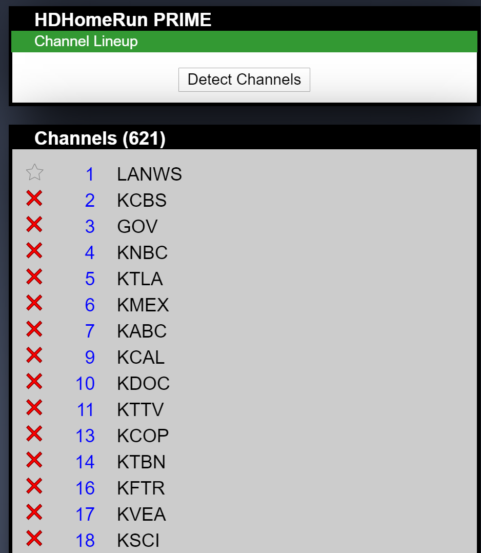

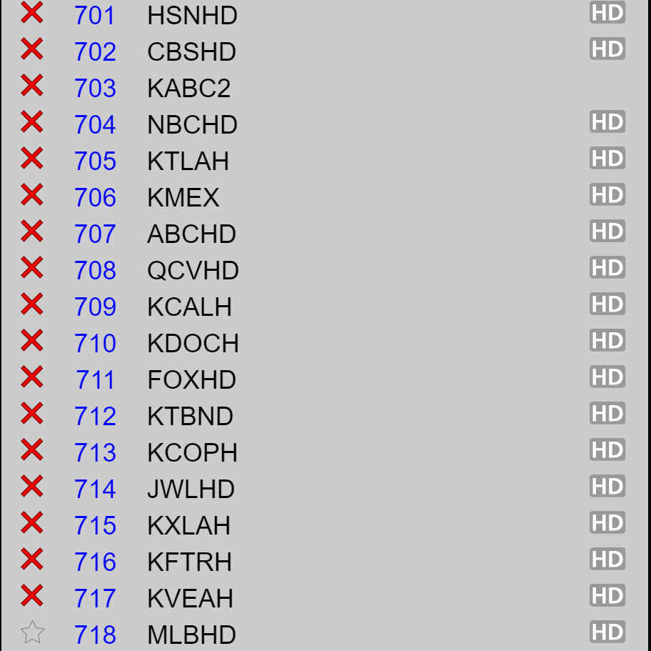

Solution Sammy 791 Posted April 23, 2020 Solution Posted April 23, 2020 (edited) I run two Quatros and two Primes SBS for a total of 14 tuners. I never miss a recording except in a rare case when my network is down or the CableTV is out. EDIT I do have the locals set as off in the Prime Tuner Channel Lineups. This really isn't an issue though because the channel numbers aren't the same. As long as there is no overlapping channel numbers or you set the ones that do overlap as off you won't have any issues whatsoever. You can select two or more epg's and assign the epg's to the tuners. Tuner management is on the long term horizon for Emby but I wish it would move to the front of development.. Edited April 23, 2020 by Sammy 1

MBSki 1115 Posted April 23, 2020 Author Posted April 23, 2020 @@Sammy, one question...how did you set the locals off in the Prime tuner channel setup? The only way that I've found to hide channels is to mark the ones that i want as favorites and only show the favorites.
Sammy 791 Posted April 23, 2020 Posted April 23, 2020 Double Click on the star to make it an "X". A single click makes it a Favorite which is easier to choose in Emby if you want to include just a few channels. 1
MBSki 1115 Posted April 23, 2020 Author Posted April 23, 2020 Double Click on the star to make it an "X". A single click makes it a Favorite which is easier to choose in Emby if you want to include just a few channels. Got it, thanks! Wish SiliconDust or Emby made it easier to manage the tuners. Some kind of multi-select option would be nice. But it'll do for now. Time to check out the kickstarter.
