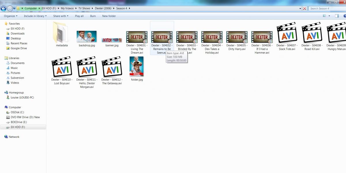

steelgear 2 Posted October 10, 2013 Posted October 10, 2013 I have a similar problem but in addition after the last scan all my tv shows season level folders are being treated as separate shows. The metadata for all these shows are stored locally and has not changed
gcw07 347 Posted October 10, 2013 Posted October 10, 2013 I have a similar problem but in addition after the last scan all my tv shows season level folders are being treated as separate shows. The metadata for all these shows are stored locally and has not changed mb problem.jpg Can you show us a screenshot of your folders. Like a screenshot of a folder that has your Series folder in them and a screenshot of the contents of a series folder itself. Thanks.

steelgear 2 Posted October 10, 2013 Posted October 10, 2013 Ok here's the requested pictures of the the TV show folder structure at the three different levels. all the show folders seasons within that and episode in a series . FYI the server version is 3.0.5031.21343
steelgear 2 Posted October 10, 2013 Posted October 10, 2013 Ok here's the requested pictures of the the TV show folder structure at the three different levels. all the show folders seasons within that and episodes in a series . FYI the server version is 3.0.5031.21343
