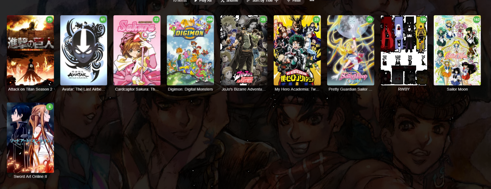

BigJazzz 0 Posted April 21, 2020 Posted April 21, 2020 (edited) EDIT: I have resolved this issue. Please see the last post. Hey guys I've had a look and can't seem to see anyone who's had this particular issue, but if they have please point me in their direction. I'm moving over to Emby from Plex. I have three different versions of Sailor Moon: the DiC dub, the VIZ dub, and the Japanese sub. The DiC dub was heavily edited so has less episodes than the original Japanese version (and is a season short), however VIZ have dubbed the full series, including the undubbed season. What I'm noticing is that only one version of Sailor Moon is showing in Emby, and I can't seem to see even different versions of the same episode. The folders are named separately and the files are following the same naming conventions. Plex would show the DiC dub as a separate show, but would merge the VIZ dub and the original Sailor Moon as they were identical except for the language audio. How do I get all four shows to show up in Emby? I'm willing to edit NFO files if necessary. Also, if you require further information, please let me know. Cheers Folders: Emby Library: Edited April 23, 2020 by BigJazzz

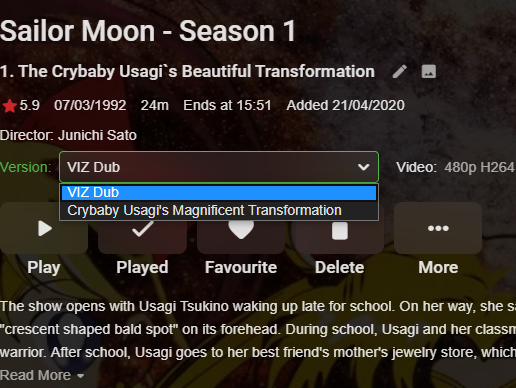

BigJazzz 0 Posted April 21, 2020 Author Posted April 21, 2020 Oh wow. That took a few clicks for me to find the versioning! Ok, so it's merged the sub and VIZ dubs together, which I can deal with. However, it's also pulled the DiC dub in as well, which obvioulsy isn't what I wanted. I've renamed the DiC folder, but it's still referencing the old folder name for some reason. I'll see if I can flush the cache somehow.

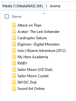

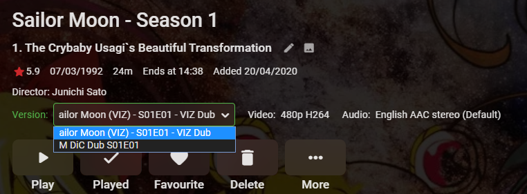

BigJazzz 0 Posted April 22, 2020 Author Posted April 22, 2020 (edited) So I renamed the DiC folder to SM DiC Dub, renamed the files to SM DiC Dub SXXEXX, and... I'm so confused. Is it because it's still in the Anime folder? O.o I'm also not sure why it's cutting off the first letter. Edited April 22, 2020 by BigJazzz
pwhodges 2121 Posted April 22, 2020 Posted April 22, 2020 (edited) Are the folders containing your versions all together in an over-arching "Sailor Moon" (or something) directory which is not the library's base directory? Because then I think they will contnue to be combined. That combining is the reason for the odd naming of the versions - multiple versions are listed from the first character which is different. So when Emby combines "Sailor Moon..." and "SM..." only the "S" gets left out. Make sure the folder containing the DiC version is in your library's base folder, and things may start to come together (or rather, apart!) for you. Paul Edited April 22, 2020 by pwhodges
pwhodges 2121 Posted April 22, 2020 Posted April 22, 2020 OK, I've confirmed that having the DiC version in a separate first-level folder makes it separate. It gets identified as the normal version, so I get two identical entries in the library. I then edit the series metadata to change the title to say "Sailor Moon (DiC dub)", so that I can tell which is which. I could also change the primary image so that the difference is more obvious. But of course the episodes of the DiC dub are identified wrongly. May I suggest a way to get the descriptions right, in the absence of any online help? Find a list of the correspondences between the DiC dub and the original episodes and rename the DiC episodes using the numbers of their originals (as you will be increasing the numbers, do this starting from the last so that you don't keep getting clashes with existing numbers!) - keep the original number in brackets after the episode title to avoid losing your place, which will be OK as the "s01enn" version will be used by Emby. The last episode corresponds with the last two of the original, so you should number it "s01e45-e46" which combines the two descriptions. That way you get largely right metadata, though with "wrong" episode numbers - which I suppose you could edit back if you wanted. Paul
BigJazzz 0 Posted April 23, 2020 Author Posted April 23, 2020 (edited) I really appreciate the help you're giving me mate. You're a champ. Are the folders containing your versions all together in an over-arching "Sailor Moon" (or something) directory which is not the library's base directory? Because then I think they will contnue to be combined. That combining is the reason for the odd naming of the versions - multiple versions are listed from the first character which is different. So when Emby combines "Sailor Moon..." and "SM..." only the "S" gets left out. Make sure the folder containing the DiC version is in your library's base folder, and things may start to come together (or rather, apart!) for you. Paul So the folders are all in the base Anime folder. They're all separate. OK, I've confirmed that having the DiC version in a separate first-level folder makes it separate. It gets identified as the normal version, so I get two identical entries in the library. I then edit the series metadata to change the title to say "Sailor Moon (DiC dub)", so that I can tell which is which. I could also change the primary image so that the difference is more obvious. But of course the episodes of the DiC dub are identified wrongly. May I suggest a way to get the descriptions right, in the absence of any online help? Find a list of the correspondences between the DiC dub and the original episodes and rename the DiC episodes using the numbers of their originals (as you will be increasing the numbers, do this starting from the last so that you don't keep getting clashes with existing numbers!) - keep the original number in brackets after the episode title to avoid losing your place, which will be OK as the "s01enn" version will be used by Emby. The last episode corresponds with the last two of the original, so you should number it "s01e45-e46" which combines the two descriptions. That way you get largely right metadata, though with "wrong" episode numbers - which I suppose you could edit back if you wanted. Paul I really don't know what I've done, because I'm still getting them merged all into one. I've even gone so far as to remove the Anime library, make sure the folders and episodes are renamed, then readded the library, all to reach the same point. I wonder if deleting the NFO data for each series will help? Maybe there's something in there that's causing it to merge the data. Edit: This did the trick, apparently! Edited April 23, 2020 by BigJazzz
BigJazzz 0 Posted April 23, 2020 Author Posted April 23, 2020 Good news! I fixed it up! I merged the dub and sub into the one folder, using the " - [extra data]" method. Paul, I honestly can't thank you enough for your help and patience, you've been a godsend!
BigJazzz 0 Posted April 23, 2020 Author Posted April 23, 2020 (edited) If you're having a similar issue: Merge the different versions into one folder, and add " - [version info]" to the end of the file name. Clear out the .nfo files, and refresh the metadata (identifying the show if required) If you want to keep a version separate, rename the folder to something not closely related to the main folder name Delete any current .nfo files Scan the library Find the new item in Emby Edit Metadata, and change the show name -> Scroll to the bottom and lock the metadata Edited April 23, 2020 by BigJazzz
