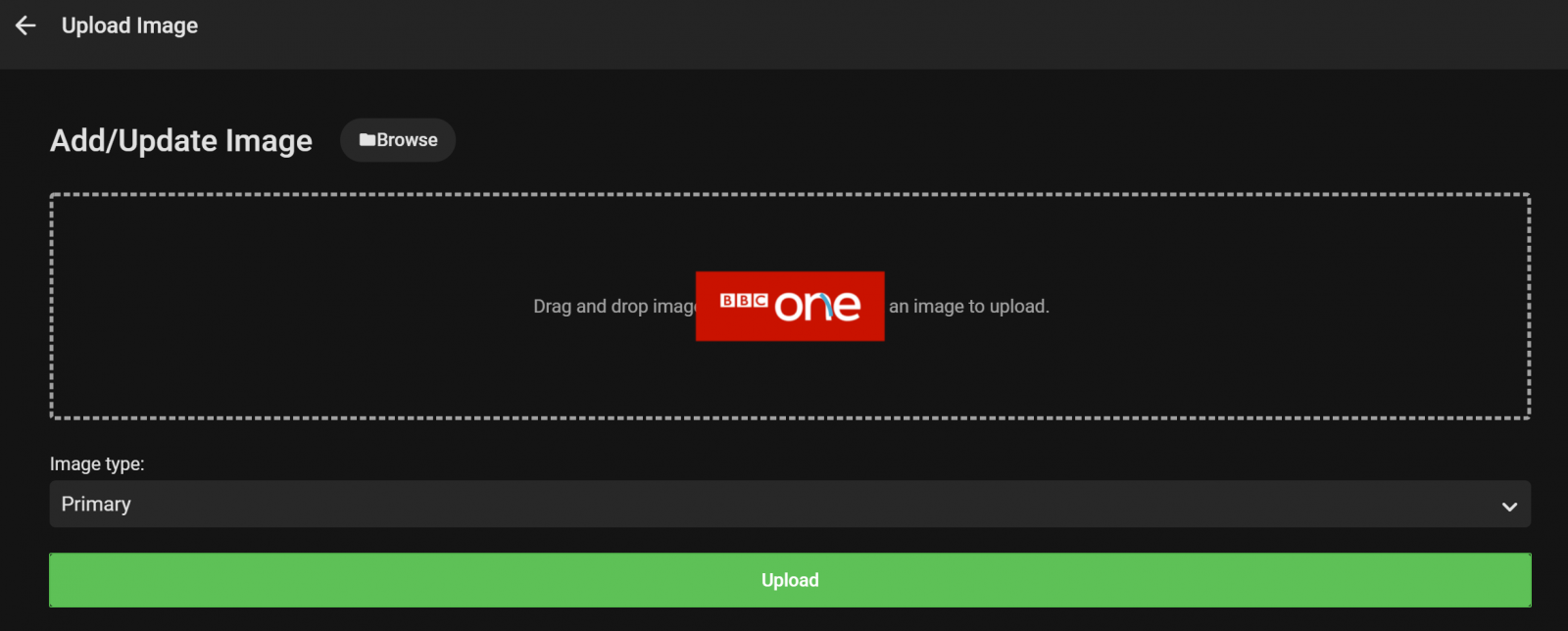

lardners 8 Posted April 17, 2020 Posted April 17, 2020 Hi, I can't upload images to Emby regardless of size or type (Jpeg or PNG). It just shows the spinning circle endlessly. Any idea why this is?
