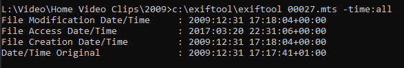

warrencalvert 16 Posted April 13, 2020 Author Posted April 13, 2020 Thanks, that's making more sense now I understand what 'Release Date' and 'Date Added' mean in Emby. Most of the videos are being sorted correctly but some are showing incorrect dates. Please could you take a look at the attached screenshots and let me know where else Emby could be getting the incorrect date from. The video is dated 31/12/2009 but Emby is showing 8/1/2010. I've checked all the file properties and metadata I can think of but cannot see where its getting the date from for this video. It must be getting it from somewhere - any ideas where to look? thanks,

warrencalvert 16 Posted April 14, 2020 Author Posted April 14, 2020 Hi Dont worry about release date, now I know that's only used for commercial productions we can leave that. If I can use Date Added to achieve sorting of home videos by date then that's all I need. So my outstanding issue is that some of the videos that Emby imports have an incorrect Date Added. As per the screenshots I posted earlier for video named 00027.mts I cant see where the date of 8/1/2010 is coming from since all the fields I can see for this file are dated 31/12/2009 Can you advise where Emby gets the 'Date Added' metadata from? Does it depend on file type? Is there a set logic it follows? I've attached one of the problematic files (the forum wouldnt let me upload an .MTS file so I've zipped it - please extract the video from the zip), please can you see if you can work out where its getting this date from so I can correct it? thanks, 00027.zip

warrencalvert 16 Posted April 14, 2020 Author Posted April 14, 2020 Thanks both for the suggestions. I checked the settings and the Date added behaviour for new content is set to file creation date. Thanks for pointing this out - so it is set correctly and is working as expected in most cases. Thanks for the renaming suggestion, I have considered this but would rather not if it can be avoided. Emby does work and sort correctly in the majority of cases, it just appears to be a few isolated videos as mentioned above where I cant see where Emby is getting the incorrect date from. All I can think is that there's some hidden metadata in the file that Emby is picking up but none of the tools I have tried are showing it. Luke, if you're able to advise on the file 00027.mts I attached I'd be very grateful. many thanks

Solution warrencalvert 16 Posted April 15, 2020 Author Solution Posted April 15, 2020 Actually, one last update that may be helpful for anyone else who encounters this. I finally found the issue. Although these files were dated correctly, I spotted there were some sidecar files with extension xml. These had the wrong date and this is where Emby was getting the date added from. I've deleted these now and relying just on the metadata and file properties of the mts files themselves. Everything is sorted in the correct order now. thanks everyone for helping. 1
