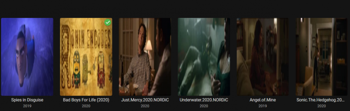

Koml 0 Posted April 10, 2020 Author Posted April 10, 2020 thanks for fast response. I have no clue what o could show you but i will try my best. Here are one screengrab that shows no information in server version and one that shows that new data is not getting metadata. just for information this has happend during use of the same version of emby since i did not get notice to upgrade. Is there something more you need to help me here just let me know. Thanks server log.txt
Koml 0 Posted April 11, 2020 Author Posted April 11, 2020 Have this message in alerts. Name or service not knownat Emby.Server.Implementations.HttpClientManager.CoreHttpClientManager.SendAsyncInternal(HttpRequestOptions options, String httpMethod)at Emby.Server.Implementations.HttpClientManager.CoreHttpClientManager.SendAsync(HttpRequestOptions options, String httpMethod)at MediaBrowser.Common.Updates.GithubUpdater.CheckForUpdateResult(String organzation, String repository, Version minVersion, PackageVersionClass updateLevel, String assetFilename, String packageName, String targetFilename, TimeSpan cacheLength, CancellationToken cancellationToken)at Emby.Server.Implementations.ApplicationHost.CheckForApplicationUpdate(CancellationToken cancellationToken, IProgress`1 progress)at Emby.Server.Implementations.ScheduledTasks.SystemUpdateTask.Execute(CancellationToken cancellationToken, IProgress`1 progress)at Emby.Server.Implementations.ScheduledTasks.ScheduledTaskWorker.ExecuteInternal(TaskOptions options)
Luke 42246 Posted April 12, 2020 Posted April 12, 2020 Yes the release notes are pulled from GitHub so it's the same issue. Have you checked your firewall, security software or VPN? Most likely something is blocking emby server from making outbound connections.
