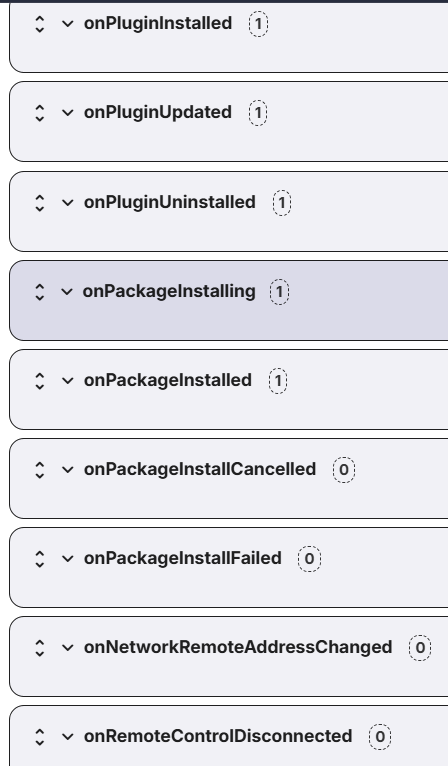

Version 6.1.0.0 released on Catalog;
General
  • Added the following new events:
    • onPluginInstalled
    • onPluginUpdated
    • onPluginUninstalled
    • onPackageInstalling
    • onPackageInstalled
    • onPackageInstallCancelled
    • onPackageInstallFailed
    • onRemoteControlDisconnected
  • Added the following new tokens to Session group:
    • %client%
    • %device.type%
    • %has.custom.device.name%
    • %last.activity.date%
    • %party.id%
    • %protocol%
    • %device.endpoint.ip%
    • %supports.remote.control%
    • %user.image.tag%
  • Added new subset of global tokens (available to all actions & events)
    • NetworkInformation
      • %remote.ip.addresses% - Comma separated string listing all remote IP addresses for the server.
      • %local.ip.addresses% - Comma separated string listing all local IP addresses for the server.
      • %mac.addresses% - Comma separated string listing all mac addresses for the server.
  • Reintroduced event:
    • onNetworkRemoteAddressChanged
This version (and all future versions released) will require emby server 4.9.5+, however I'll add the DLL file to the Releases page on GitHub incase anyone with an older server install wants to test it.
Some script examples for the new events:
package_installing.sh
#!/bin/bash
# Parameters expected: "%package.name%" "%package.version%" "%package.classification%" "%package.description%" "%package.checksum%" "%package.target.filename%" "%package.timestamp%" "%installation.id%" "%installation.name%" "%installation.version%" "%installation.update.class%"
echo Package Installing: [name: $1] [version: $2] [classification: $3] [desc: $4] [checksum: $5] [target filename: $6] [timestamp: $7] [installId: $8] [installName: $9] [installVersion: ${10}] [installUpdateClass: ${11}]  >> packages.log
package_installed.sh
#!/bin/bash
# Parameters expected: "%package.name%" "%package.version%" "%package.classification%" "%package.description%" "%package.checksum%" "%package.target.filename%" "%package.timestamp%" "%installation.id%" "%installation.name%" "%installation.version%" "%installation.update.class%" "%package.sourceurl%"
echo Package Installed: [name: $1] [version: $2] [classification: $3] [desc: $4] [checksum: $5] [target filename: $6] [timestamp: $7] [installId: $8] [installName: $9] [installVersion: ${10}] [installUpdateClass: ${11}] [sourceUrl: ${12}] >> packages.log
packages.log
Package Installing: [name: Emby Diagnostics] [version: 4.8.0.81] [classification: Release] [desc: Compatibility Update] [checksum: 79171208ef8012747367e2617d95e5f0] [target filename: Emby.DiagnosticsPlugin.dll] [timestamp: 4/11/2025 2:07:03 PM +00:00] [installId: 3e9cb5e5-403f-43ea-9f8c-2780db08b2ad] [installName: Emby Diagnostics] [installVersion: 4.8.0.81] [installUpdateClass: Release]
Package Installed: [name: Emby Diagnostics] [version: 4.8.0.81] [classification: Release] [desc: Compatibility Update] [checksum: 79171208ef8012747367e2617d95e5f0] [target filename: Emby.DiagnosticsPlugin.dll] [timestamp: 4/11/2025 2:07:03 PM +00:00] [installId: 3e9cb5e5-403f-43ea-9f8c-2780db08b2ad] [installName: Emby Diagnostics] [installVersion: 4.8.0.81] [installUpdateClass: Release] [sourceUrl: https://embydata.com/admin/service/packageFiles/Emby.DiagnosticsPlugin.dll_4.8.0.81.exe]
plugin_installed.sh
#!/bin/bash
# Parameters expected: "%package.name%" "%package.version%" "%package.sourceurl%" "%package.classification%" "%package.description%" "%package.checksum%" "%package.target.filename%" "%page.timestamp%"
echo Plugin Installed [Name: $1] [Version: $2] [SourceURL: $3] [Classification: $4] [Desc: $5] [Checksum: $6] [Target Filename: $7] [Timestamp: $8] >> plugins.log
plugin_uninstalled.sh
#!/bin/bash
# Parameters expected:   %plugin.id% "%plugin.name%" %plugin.version%
echo Plugin Uninstalled [Plugin ID: $1] [Name: $2] [Version: $3]  >> plugins.log
plugins.log
Plugin Installed [Name: Emby Diagnostics] [Version: 4.8.0.81] [SourceURL: https://embydata.com/admin/service/packageFiles/Emby.DiagnosticsPlugin.dll_4.8.0.81.exe] [Classification: Release] [Desc: Compatibility Update] [Checksum: 79171208ef8012747367e2617d95e5f0] [Target Filename: Emby.DiagnosticsPlugin.dll] [Timestamp: 4/11/2025 2:07:03 PM +00:00]
Plugin Uninstalled [Plugin ID: 2ea04f4b-a776-428e-9869-58e8e5b149c2] [Name: Diagnostics PlugIn] [Version: 4.8.0.81]

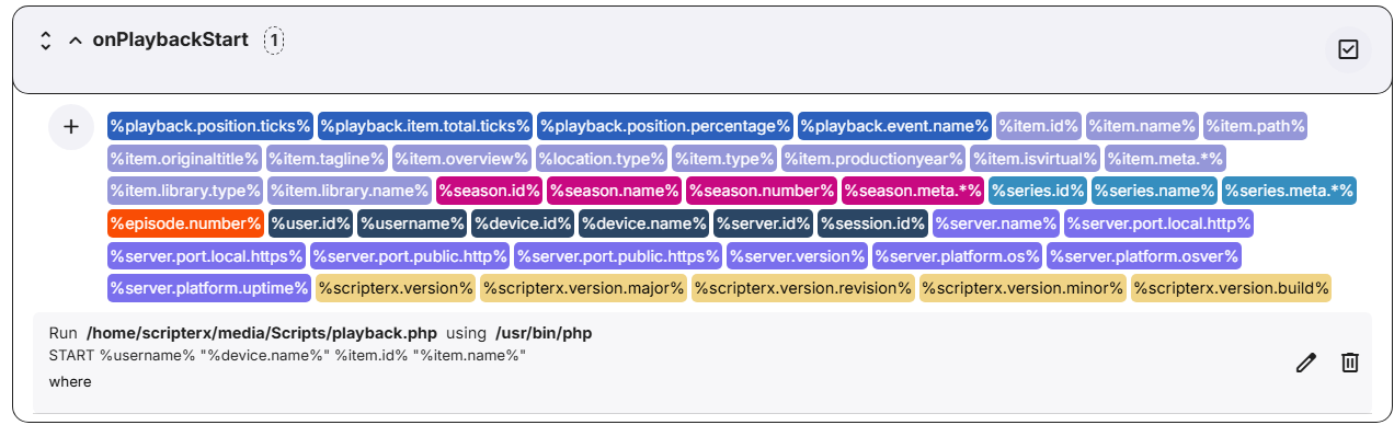

Network Information
%remote.ip.addresses%     %local.ip.addresses%    %mac.addresses%
[Remote IP Addresses: $6] [Local IP Addresses: $7] [MAC Addresses: $8] >>
[Remote IP Addresses: 100.200.100.20] [Local IP Addresses: 192.168.1.40,fe80::a00:27ff:fe47:c18a%2,127.0.0.1,::1] [MAC Addresses: 08001148B2C4]

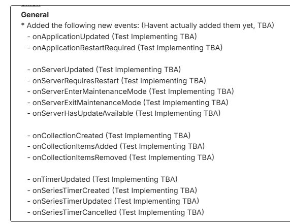

Anthony Musgrove
And currently working on implementing these events for next release :-
  • Like 1

Anthony Musgrove
Emby Scripter-X v6.1.0.1 released on Emby Catalog
6.1.0.1
General
* Added the following new events:
   - onApplicationUpdated
   - onApplicationRestartRequired
   - onServerUpdated
   - onServerRequiresRestart
   - onServerEnterMaintenanceMode
   - onServerExitMaintenanceMode
   - onServerHasUpdateAvailable
   - onCollectionCreated
   - onCollectionItemsAdded
   - onCollectionItemsRemoved
* Added new tokens for Collection events:
   - %collection.id%, %collection.name%, %collection.date.created%
   - %collection.items.changed% - comma separated string of all ids of items changed (added/removed)
   - %collection.itemschanged.count% - number of items changed
  • Like 1
