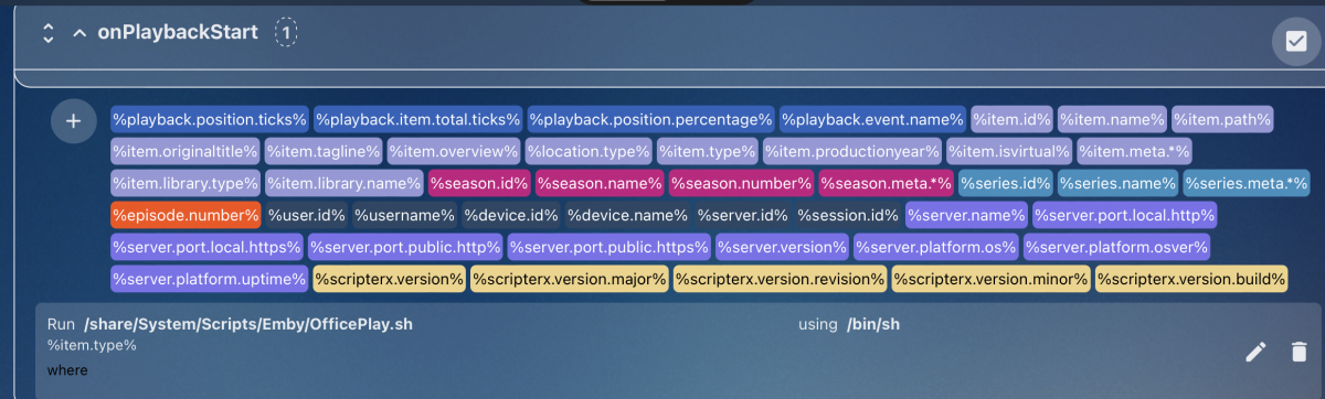

somy 25 Posted August 15, 2024 Posted August 15, 2024 Hi all, Would like some help as I don't spot the issue myself... I'd like to use ScripterX to control some automation at home, and I create a bash script that sends HTTP requests to my home automation system. Below is "EmbyPlay.sh" script: #!/bin/bash curl -X POST --header "Content-Type: text/plain" --header "Accept: application/json" -d "ON" "10.1.x.x:8081/rest/items/Emby_Office_Play" curl -X POST --header "Content-Type: text/plain" --header "Accept: application/json" -d ""$1"" "10.1.x.x:8081/rest/items/Emby_Office_MediaType" I have given the permission to the script, and it also works when I run it. Essentially the script send post request to 2 endpoints to inform playback starts with the media type as parameter. Below is how I configure in GUI: In emby log I can see the following when playback starts: 2024-08-15 20:38:48.236 Info Emby ScripterX: 2e9a4b73-def3-47ba-850e-1dfeb661b406: Executing with substituted tokens: Movie 2024-08-15 20:38:48.236 Info Emby ScripterX: onPlaybackStart: Movie However the script doesn't seem to run for some reason, and I don't see any error in emby log. I'm running Emby on my NAS based on Linux. I must be blind and missed something obvious, maybe somebody can point out? I also noticed there is an action called "web.post", doesn't anyone have an example how it works? I tried to looked for here (https://github.com/AnthonyMusgrove/Emby-ScripterX/tree/master/Beta) without luck.. Thank you in advance!
GavinCampbell 16 Posted September 26, 2024 Posted September 26, 2024 On 8/15/2024 at 2:57 PM, somy said: However the script doesn't seem to run for some reason, and I don't see any error in emby log. I'm running Emby on my NAS based on Linux. I must be blind and missed something obvious, maybe somebody can point out? Was having a similar issue. Looks like curl does not work in the scripterx environment. I was trying to do a curl delete and finally was able to get my script to output the curl errors. I had to convert my script to use an nc workaround but I have a more complicated script that I don't know what I'm going to do with. This use to work until recently. Hopefully one day it can be enabled again.

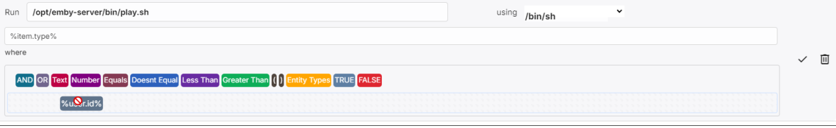

3agle3ye 0 Posted January 3, 2025 Posted January 3, 2025 (edited) Hello everyone, I am trying to user ScripterX to get information out of Emby to my OpenHAB home automation. Unfortunately there is no way to drag&drop any of the items to create rules. As described by KeithA and also confirmed by Ilicitano81 only red X appears and won't let me drop anything as shown in the attached screenshot. I tried all possible browser with and without private tabs / adblocker / script blocker but it doesnt want to work. I am using Uptodate Emby Server 4.8.10.0 with ScripterX 5.0.0.5. Edited January 3, 2025 by 3agle3ye
TMCsw 260 Posted January 3, 2025 Posted January 3, 2025 15 hours ago, 3agle3ye said: Hello everyone, I am trying to user ScripterX to get information out of Emby to my OpenHAB home automation. Unfortunately there is no way to drag&drop any of the items to create rules. As described by KeithA and also confirmed by Ilicitano81 only red X appears and won't let me drop anything as shown in the attached screenshot. I tried all possible browser with and without private tabs / adblocker / script blocker but it doesnt want to work. I am using Uptodate Emby Server 4.8.10.0 with ScripterX 5.0.0.5. Unfortunately you will have to type them in manually but if you get the syntax right it will work ...
3agle3ye 0 Posted January 4, 2025 Posted January 4, 2025 7 hours ago, TMCsw said: Unfortunately you will have to type them in manually but if you get the syntax right it will work ... Yes ... tried that already ... as the condition field is not a text field on my browsers this will not work. And i need that field to have only one user (the one on my living room tv) starting the scripts so my home automation can recognize which media type is running and setup the sound system and light accordingly. The parameters field of course can be filled manually.
TMCsw 260 Posted January 4, 2025 Posted January 4, 2025 16 hours ago, 3agle3ye said: Yes ... tried that already ... as the condition field is not a text field on my browsers this will not work. Guess your right, just tried again this isn't working any more @Anthony Musgrove

ados8000 53 Posted February 7, 2025 Posted February 7, 2025 On 1/3/2025 at 5:50 PM, 3agle3ye said: Hello everyone, I am trying to user ScripterX to get information out of Emby to my OpenHAB home automation. Unfortunately there is no way to drag&drop any of the items to create rules. As described by KeithA and also confirmed by Ilicitano81 only red X appears and won't let me drop anything as shown in the attached screenshot. I tried all possible browser with and without private tabs / adblocker / script blocker but it doesnt want to work. I am using Uptodate Emby Server 4.8.10.0 with ScripterX 5.0.0.5. Sadly still doesn't work, you can only modify an existing text based variable. The biggest thing I miss from Plex to Emby was Tautulli.
