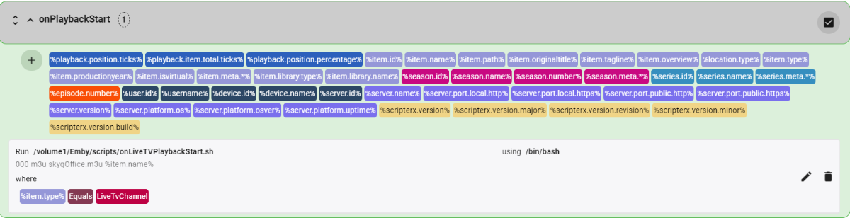

rafinha 8 Posted May 10, 2021 Posted May 10, 2021 Is this still working? I'm trying to send a post to my endpoint using scripterx by @Anthony Musgrove and I don't get anything. Look the image attached. I know I can use the webhooks from emby, but the problem is that emby webhooks, doesn't have an "onMediaItemAdded" option. Anybody know how to use the post option from scripterx ? Thanks
ChrisHammond56 4 Posted May 10, 2021 Posted May 10, 2021 Working still with my options, but I am using a local BASH/Python script.
harrv 90 Posted May 10, 2021 Posted May 10, 2021 1 hour ago, rafinha said: Is this still working? I'm trying to send a post to my endpoint using scripterx by @Anthony Musgrove and I don't get anything. Look the image attached. I know I can use the webhooks from emby, but the problem is that emby webhooks, doesn't have an "onMediaItemAdded" option. Anybody know how to use the post option from scripterx ? Thanks Yes, I see at least one problem, and maybe three. A web post requires a payload template, and you haven't specified one. The template is a text file that contains whatever you want to be posted to your web hook. It has variables in it that correspond to the data Scripter-X knows how to resolve for the event. Here is what mine looks like for onMediaItemAddedComplete (which is more useful than onMediaItemAdded assuming you want to take some action when something is actually done being added and not just when something new is detected but has not finished adding yet): { "Event": "scripterx.mediaitem.added.complete", "item.id": "%item.id%", "item.name": "%item.name%", "item.originaltitle": "%item.originaltitle%", "item.tagline": "%item.tagline%", "item.overview": "%item.overview%", "item.type": "%item.type%", "item.productionyear": "%item.productionyear%", "item.isvirtual": "%item.isvirtual%", "item.library.type": "%item.library.type%", "item.library.name": "%item.library.name%", "season.id": "%season.id%", "season.name": "%season.name%", "season.number": "%season.number%", "series.id": "%series.id%", "series.name": "%series.name%", "episode.number": "%episode.number%", "embyServer": { "id": "%server.id%", "name": "%server.name%", "version": "%server.version%", "platform": { "os": "%server.platform.os%", "osVersion": "%server.platform.osver%", "upTime": "%server.platform.uptime%" } }, "scripterx": { "version": { "full": "%scripterx.version%", "major": "%scripterx.version.major%", "minor": "%scripterx.version.minor%", "build": "%scripterx.version.build%", "revision": "%scripterx.version.revision%" } } } I saved that file as MediaItemAddedComplete.json on my Emby server and then when I configured Scripter-X for that event I specified the full path to that template file in the field immediately below the run field. Potential problem #2: Notice that I don't use a where clause. That's because I want to use this same config for all onMediaItemAddedComplete events. You only need a where clause if you want to filter the events based on something in a variable. For example, if I wanted to have different templates or call a different web hook depending on whether it is a movie or a TV episode being added, I would use a where clause for that. I see that you have a where clause, and that it doesn't make much sense. I assume you were trying to use it to specify what you want to be posted, but you need to use a payload template for that, as described above. Potential problem #3: You specifically mentioned the onMediaItemAdded event, but your screenshot shows that you configured the onPlaybackStart event. I will assume that this isn't a problem and that you are actually configuring both events and happened to post a screenshot of onPlaybackStart rather than onMediaItemAdded. I hope this helps! 1 1
rafinha 8 Posted May 10, 2021 Posted May 10, 2021 thanks @harrv, this help me a lot, I see how it works \o/. Thanks again
