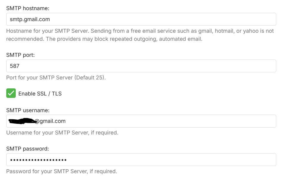

HawkXP71 112 Posted March 3, 2025 Posted March 3, 2025 1 hour ago, Luke said: Are you sure you configured the right values? Looks like the host is not responding. I have used the 16 character code from gmails app password feature. Both with and without spaces. I have attached a screen shot of the gmail settings Any ideas?
darkassassin07 666 Posted March 3, 2025 Posted March 3, 2025 Same error as above? That error would indicate a network issue. Either the name is resolving to an incorrect ip which isn't listening for connections, the connection is being blocked by a firewall, or there's a problem routing the packets correctly. Verify the server can reach smtp.gmail.com on port 587 using telnet or nmap.
HawkXP71 112 Posted March 3, 2025 Posted March 3, 2025 1 hour ago, darkassassin07 said: smtp.gmail.com 587 tls enabled. Requires the email as a username + an app password when you say user name + an app password say I had app name "emby" and the generated password is "aaaa bbbb cccc dddd" for an email of "yyy@gmail.com" woudl the user name be yyy@gmail.com aaa bbb ccc dddd Sorry for being so dense, Ive tried just about everything to no avail nmap works fine for 587 to smtp.gmail.com
darkassassin07 666 Posted March 3, 2025 Posted March 3, 2025 Yeah, the username is your email address

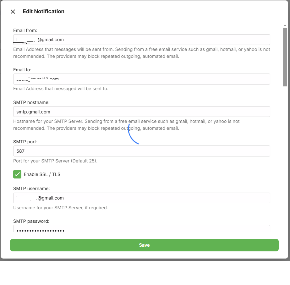

MAX92 91 Posted March 14, 2025 Posted March 14, 2025 (edited) I don't understand. I try and I have this error: The SMTP server requires a secure connection or the client was not authenticated. The server response was: 5.7.0 Authentication Required. For more information, go to I have user : yyy@gmail.com and password : aaa bbb ccc dddd Edited March 14, 2025 by MAX92
Luke 42151 Posted March 15, 2025 Posted March 15, 2025 12 hours ago, MAX92 said: I don't understand. I try and I have this error: The SMTP server requires a secure connection or the client was not authenticated. The server response was: 5.7.0 Authentication Required. For more information, go to I have user : yyy@gmail.com and password : aaa bbb ccc dddd Hi there, please attach the emby server log: How to Report a Problem Thanks.
