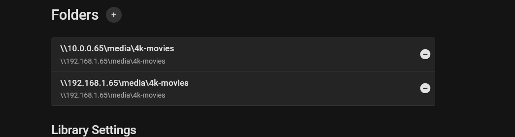

It will be using a different file share to access the data than what exists current under each media library's "folder" option.
I had planned to use the backup plugin however found that I could not edit the original "Folder" field within a library, only the "shared network folder" so my plan was to add a 2nd folder with the new location mapped.

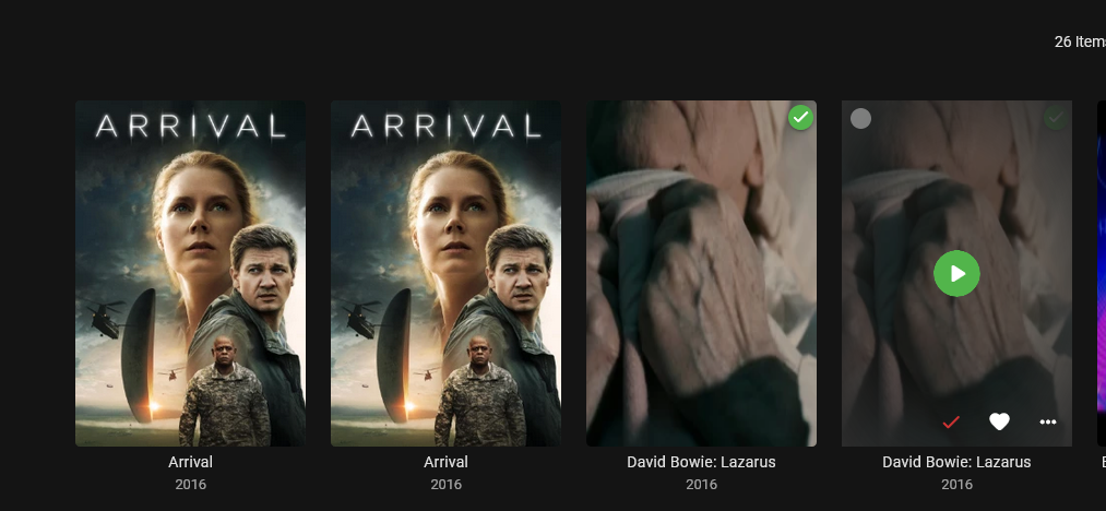

While testing this, adding a 2nd folder that points to a new logical location....but same physical location...results in duplicate entries within the library.
Is this expected behavior?  I assume that if I DO migrate, and remove the old folder location that I will lose all watch status associated with those items as playback status does not appear to be linked between the duplicate entries.

Yes this is expected behaviour do to each attached folder technically being different locations.
Watched statuses are not tracked by location at all.  All watched statuses are tracked by their providerid (imdb, tmdb, tvdb).  Only items that would ever lose watched status would be items that do not have any providerids, they are tracked by databaseid and that is lost when the path changes as the item is removed and re-added to the database.
Just like you see your currently duplicated items are both showing watched.
