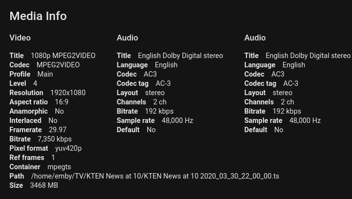

sfatula 208 Posted March 31, 2020 Posted March 31, 2020 (edited) Been seeing this fail more recently. Isn't it possible to mix interlaced video with non interlaced? ffprobe is saying the video is not interlaced. Running this command: ffmpeg -filter:v idet -frames:v 100 -an -f rawvideo -y /dev/null -i 'KTEN News at 10 2020_03_30_22_00_00.ts' Results in: [Parsed_idet_0 @ 0x557b32e66ac0] Repeated Fields: Neither: 59 Top: 0 Bottom: 0 [Parsed_idet_0 @ 0x557b32e66ac0] Single frame detection: TFF: 0 BFF: 2 Progressive: 57 Undetermined: 0 [Parsed_idet_0 @ 0x557b32e66ac0] Multi frame detection: TFF: 0 BFF: 0 Progressive: 59 Undetermined: 0 Changing to 1000 frames: ffmpeg -filter:v idet -frames:v 1000 -an -f rawvideo -y /dev/null -i 'KTEN News at 10 2020_03_30_22_00_00.ts' Results in: [Parsed_idet_0 @ 0x56365e554ac0] Repeated Fields: Neither: 754 Top: 28 Bottom: 25 [Parsed_idet_0 @ 0x56365e554ac0] Single frame detection: TFF: 123 BFF: 25 Progressive: 572 Undetermined: 87 [Parsed_idet_0 @ 0x56365e554ac0] Multi frame detection: TFF: 137 BFF: 0 Progressive: 670 Undetermined: 0 Based on that, not too surprised that ffprobe says not interlaced. I will attach the ffmpeg log, but, it is as I say. Is there any good way to better detect interlaced video? This is admittedly 4.3.1.0, there was some potential bug with deleting media libraries incorrectly in the new Emby server version, waiting for 4.4.1. But still, this video appears to be mostly progressive. This is recorded off of a HDHomeRun. Is there harm if you always deinterlace any time you are transcoding? I recall in Handbrake it was irrelevant with one of their options as it only deinterlaced specific interlaced frames so there was no harm in doing so with whatever method they were using. Looking at the media info shown by emby, is there anything else of value there that might be a hint it's interlaced? I don't see any but attaching. It just looks bad when interlaced video is not deinterlaced when transcoding. What is the command line you use to detect interlaced video? Is it a ffprobe with -show_streams? That shows a field_order of progressive. Relevant section below. I've had 3 of the last 4 NBC videos show up as not interlaced. [STREAM] index=0 codec_name=mpeg2video codec_long_name=MPEG-2 video profile=Main codec_type=video codec_time_base=1001/30000 codec_tag_string=[2][0][0][0] codec_tag=0x0002 width=1920 height=1080 coded_width=0 coded_height=0 has_b_frames=1 sample_aspect_ratio=1:1 display_aspect_ratio=16:9 pix_fmt=yuv420p level=4 color_range=tv color_space=unknown color_transfer=unknown color_primaries=unknown chroma_location=left field_order=progressive timecode=N/A refs=1 id=0x31 r_frame_rate=60000/1001 avg_frame_rate=30000/1001 time_base=1/90000 start_pts=5559937130 start_time=61777.079222 duration_ts=356197841 duration=3957.753789 bit_rate=N/A max_bit_rate=N/A bits_per_raw_sample=N/A nb_frames=N/A nb_read_frames=N/A nb_read_packets=N/A DISPOSITION:default=0 DISPOSITION:dub=0 DISPOSITION:original=0 DISPOSITION:comment=0 DISPOSITION:lyrics=0 DISPOSITION:karaoke=0 DISPOSITION:forced=0 DISPOSITION:hearing_impaired=0 DISPOSITION:visual_impaired=0 DISPOSITION:clean_effects=0 DISPOSITION:attached_pic=0 DISPOSITION:timed_thumbnails=0 [/STREAM] ffmpeg-transcode-642c4c4a-84be-42ed-9a6a-91f1822ab1ab_1.txt Edited March 31, 2020 by sfatula

softworkz 5133 Posted May 8, 2020 Posted May 8, 2020 Been seeing this fail more recently. Isn't it possible to mix interlaced video with non interlaced? ffprobe is saying the video is not interlaced. Running this command: ffmpeg -filter:v idet -frames:v 100 -an -f rawvideo -y /dev/null -i 'KTEN News at 10 2020_03_30_22_00_00.ts' There's something wrong with that detection method. I tried it on an mpegts stream with mpeg2video which is definitely interlaced and the output was total nonsense: [Parsed_idet_0 @ 00000210bed8ee80] Repeated Fields: Neither: 8720 Top: 15 Bottom: 10 [Parsed_idet_0 @ 00000210bed8ee80] Single frame detection: TFF: 4781 BFF: 3 Progressive: 2119 Undetermined: 1842 [Parsed_idet_0 @ 00000210bed8ee80] Multi frame detection: TFF: 5749 BFF: 0 Progressive: 2996 Undetermined: 0 So, there's no value in what you're getting from that command output. I'm afraid though, but right now I got no time to find out the reason (I'm not familiar with that filter).
