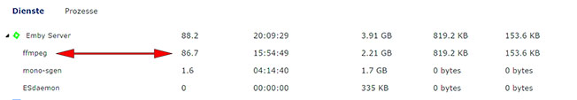

ArnoRoggo 1 Posted March 27, 2020 Posted March 27, 2020 Die CPU zeigte schon einmal eine hohe Auslastung. Diese verminderte sich sofort, als ich die Vorschaubilder deaktivierte. Jetzt ist es wieder so weit (vgl. Anhang). Die Auslastung stammt gemäss Ressourcen-Monitor von Synology eindeutig von Emby (ffmpeg), und zwar ohne, dass ein User Emby beschäftigen würde. Auch von den geplanten Aufgaben scheint keine aktiv. Weiss jemand, wie man Genaueres herausfinden kann?

Luke 42213 Posted March 28, 2020 Posted March 28, 2020 Hi, your system is transcoding for playback and burning in subtitles. Burning in subtitles is a very costly process, even for a powerful machine. Were you not aware of this?Try turning off subtitles prior to playback and see how that compares. Thanks.

Luke 42213 Posted March 29, 2020 Posted March 29, 2020 But the reason is you still have PGS subtitles selected, and PGS is not supported by LG.
ArnoRoggo 1 Posted March 29, 2020 Author Posted March 29, 2020 Thanks Luke, thanks Mark I don't see anything unusual in the statistics. What should I put attention on? Where do I select another kind of subtitles? (Or is this already determined when I'm ripping?)
ArnoRoggo 1 Posted March 31, 2020 Author Posted March 31, 2020 In the meantime I have understood it: If the player (TV) cannot read the format of the subtitles, Emby begins to transcode. This leads to a high load on the CPU. Thanks.
