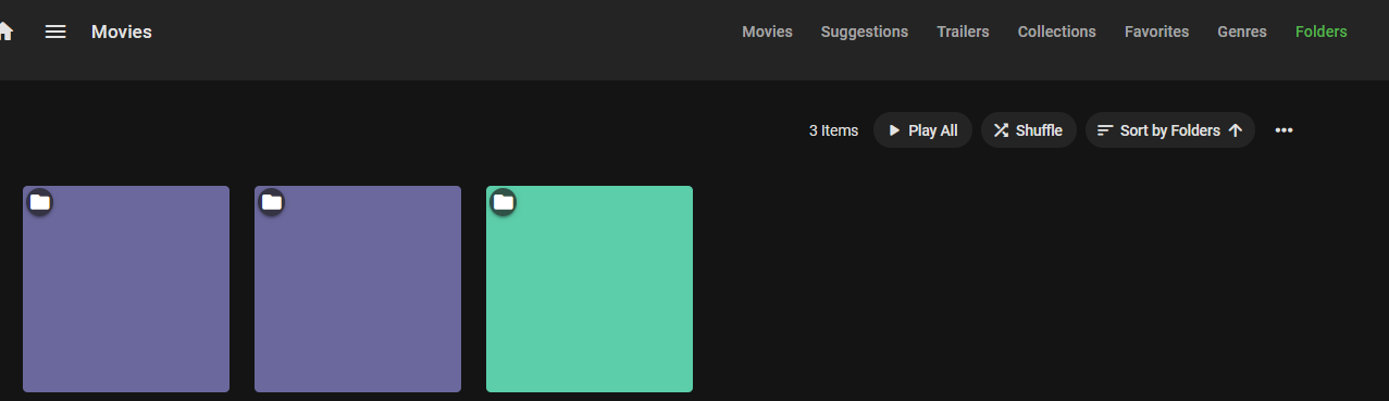

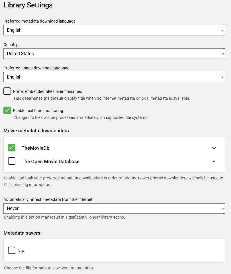

Nightshiver 1 Posted March 23, 2020 Posted March 23, 2020 Just started with emby and a fresh install. I have three hdd's with movies on them and linked them all to "Movies", however emby is only seeing movies in my I: drive and not the other two. The three drives ("folders" as emby sees it) Going into the only folder where emby actually detects movies, no posters get downloaded. The other two folders in the UI are blank when visited. Settings (with advanced toggled on) Logs have also been attached. embyserver-63720545039.txt embyserver.txt

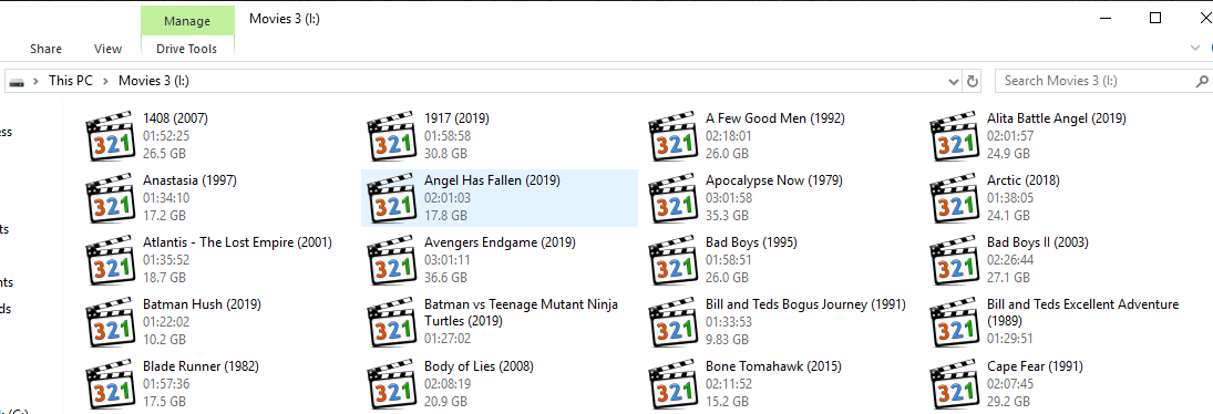

Nightshiver 1 Posted March 23, 2020 Author Posted March 23, 2020 (edited) There are no folders. I only have straight MKV files at the base of each drive. They look like this: Emby correctly saw and indexed one harddrive, but as above, is somehow not seeing the other two. All three drives are identical in layout, there are no folders in any of them (Just in case it matters, Plex has not had an issue with this format). Although this doesn't explain why even the one HDD that was detected isn't getting any movie poster metadata. If I attempt to manually "Identify" a movie and search on the movie title, the search completes with a blank page/no results. Edited March 23, 2020 by Nightshiver

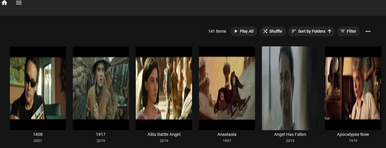

Nightshiver 1 Posted March 23, 2020 Author Posted March 23, 2020 Nope. I've managed to partially solve this issue, I put all the movies in a folder called "Movies" at the root of the drive, although I shouldn't have to do this to get them detected. Still not getting any metadata/poster matches.

Nightshiver 1 Posted March 23, 2020 Author Posted March 23, 2020 You were probably writing this before I posted my response, but I did that but there still are no metadata matching/posters.
