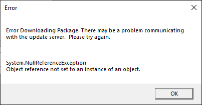

Peppe909 0 Posted March 22, 2020 Posted March 22, 2020 Hi, i have had an issue to update plugins (error: Check for application updates failed) every reboot So i wanted to reinstall emby. The next error appeared: Error downloading package...blabla Now im forced to use a portable version. Ive tried a previous solution posted on forum (Plugins won't update. - IIS Crypto) That didnt help. Ive tried to shut down firewall on my router, in windows, updated windows with all drivers which didnt help either. What is exactly the issue? Can someone help me in this case? Thanks P. embyserver.txt hardware_detection-63720494045.txt

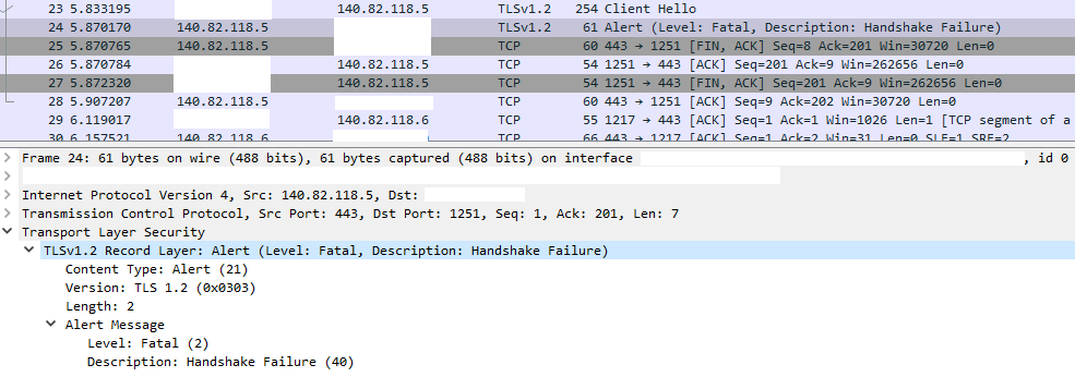

Peppe909 0 Posted March 22, 2020 Author Posted March 22, 2020 (edited) When running the setup.exe and wireshark running, it throws at the ip https://140.82.118.6/ and or https://140.82.112.6/ error SSL_ERROR_BAD_CERT_DOMAIN...for github domain. Is the issue really on my side? Here the log from wireshark: Edited March 22, 2020 by Peppe909
Luke 42214 Posted March 22, 2020 Posted March 22, 2020 Unfortunately yes because you can see it's happening with multiple domains besides github. Plugins are hosted on our domain. Is Windows fully up to date?
