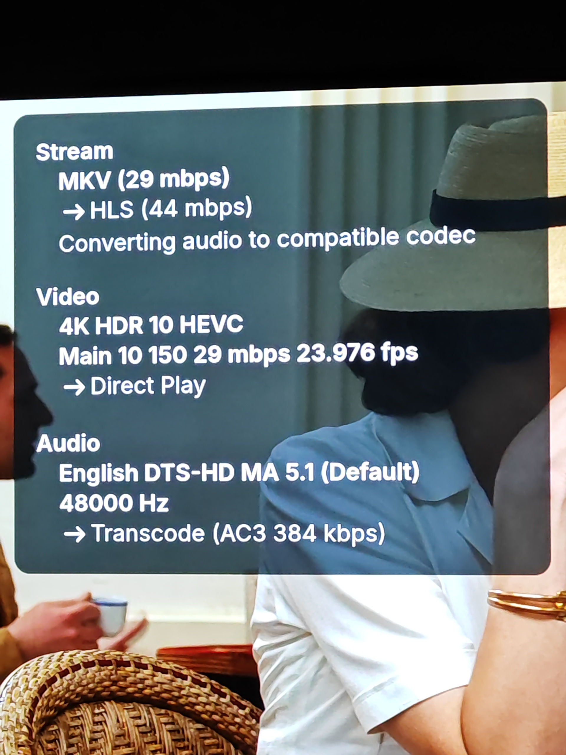

psxlover 32 Posted July 22, 2020 Author Posted July 22, 2020 Just tried the video in a Mi Box (Android TV). It also reports that it is a direct stream, with the transcode reason being "Unsupported audio" in stats for nerds, but there there is no desyncing. What I noticed though, was that when I seek backwards, sometimes the picture stays frozen for a couple of seconds while the audio is playing, and the picture starts playing when the audio and subtitles reach the point where the picture is frozen. I'm guessing the video player used is freezing the video until the audio catches up, and in the mean time the subtitles are also synced. But the player of the TV doesn't do anything like that, it start playing from the point that the video is when seeking back (with the audio being in sync with the video), but the subtitles at where the video would have been if seeking was exactly 10s. Comparing the timestamps in the .srt with what I see, the subtitles seem to show up on the correct time reported by the application. So it seems it is indeed the application that is out of sync with the video.
psxlover 32 Posted July 22, 2020 Author Posted July 22, 2020 Another issue I noticed, is that if I cast the video from my phone to the TV using DLNA, the audio is not transcoded, resulting in the TV showing a message that the audio is not supported and that it will play without audio. Also Android TV's stats for nerds contains more information about the transcode, showing information about both the original and the transcoded stream, along with the reason for the transcode, something that is missing from Samsung TV application's stats for nerds.

ZumADR 0 Posted January 6 Posted January 6 I started to have this problem on my LG TV CX ... The subs it's ok if the file has AC3 audio (second option audio) after changing the sub it's ok... But when if my only option its DTS the Subtitles going out of sync.
visproduction 335 Posted January 6 Posted January 6 (edited) Related? Out of sync subs tied to 24 and afps udio conversion is maybe set to 23.976 fps or vice versa? https://forum.videohelp.com/threads/418712-How-to-sync-a-DTS-HD-audio-track-that-is-progressively-out-of-sync-with-UHD From: https://duckduckgo.com/?q=DTS-HD+MA+audio+conversion+out+of+sync+AC3&ia=web Edited January 6 by visproduction
Luke 42237 Posted January 6 Posted January 6 9 hours ago, ZumADR said: I started to have this problem on my LG TV CX ... The subs it's ok if the file has AC3 audio (second option audio) after changing the sub it's ok... But when if my only option its DTS the Subtitles going out of sync. Hi there, let's look at an example. Please attach the information requested in how to report a media playback issue. Thanks!
