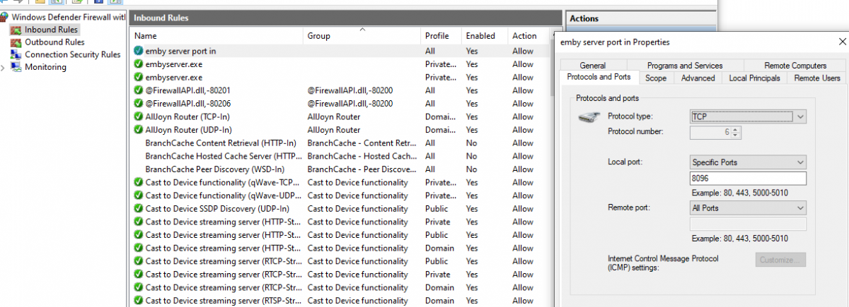

Happy2Play 9806 Posted March 18, 2020 Posted March 18, 2020 I'd already read through that. I can access via localhost on the same device but not on anything else. What firewall rules do you have for embyserver.exe? What network type is your pc network set to Public and Private?
rbjtech 5338 Posted March 19, 2020 Posted March 19, 2020 (edited) "I opened 8096 port on the server firewall." Can you share the rule as I suspect (as Happy2Play says) your Inbound firewall rule is possibly incorrect (Outbound is usually not restricted anyway) and/or and on the wrong 'profile' because emby works on the local machine. It's also worth disabling the Port Mapper plugin, but check the firewall rule first. Edited March 19, 2020 by rbjtech
joolsclop 1 Posted March 19, 2020 Author Posted March 19, 2020 (edited) "I opened 8096 port on the server firewall." Can you share the rule as I suspect (as Happy2Play says) your Inbound firewall rule is possibly incorrect (Outbound is usually not restricted anyway) and/or and on the wrong 'profile' because emby works on the local machine. It's also worth disabling the Port Mapper plugin, but check the firewall rule first. Thanks for your assistance. Firewall rule image attached. Still no joy, have tried everything I know .nothing connects. I noticed on the server under Users there is nothing and the roundal keeps spinning forever? Edited March 19, 2020 by joolsclop

rbjtech 5338 Posted March 20, 2020 Posted March 20, 2020 Thanks for your assistance. Firewall rule image attached. Still no joy, have tried everything I know .nothing connects. I noticed on the server under Users there is nothing and the roundal keeps spinning forever? What is in 'scope' ? Local subnet only ? If you are using multiple routers/VPN's/networks/VLAN's - then you'll need to include all the networks in the scope. Also worth running "netstat -a | find "8096" to confirm that emby is listening on IP x and port 8096. If you have another PC on the same network as the emby server, then does that connect ok ? Lets start with the basics ..
