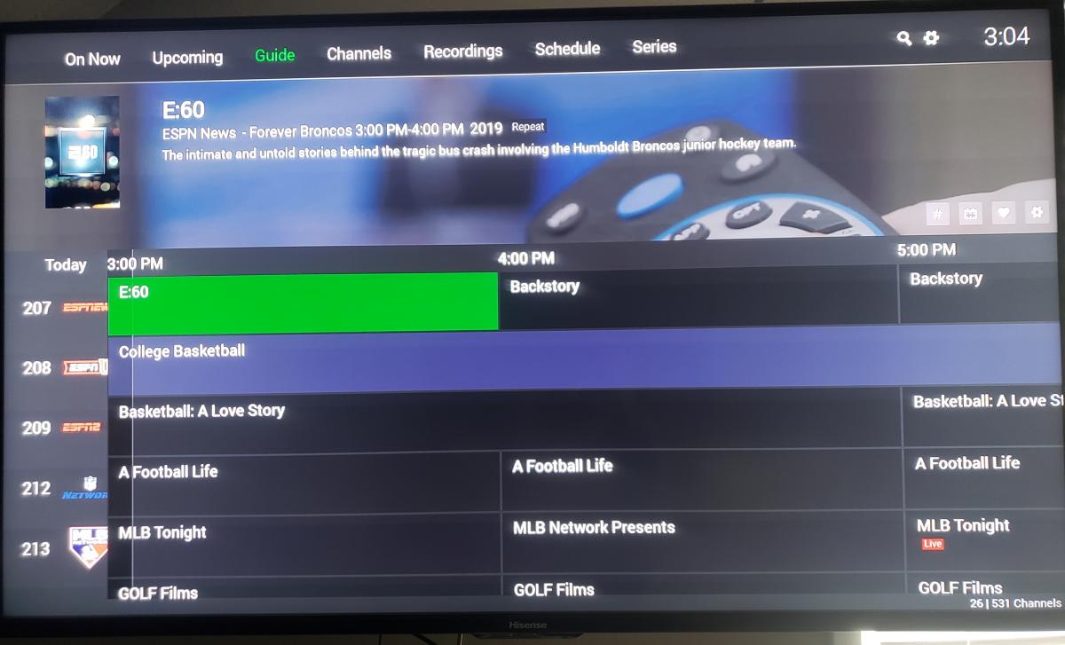

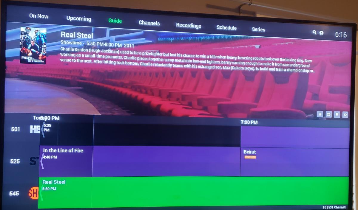

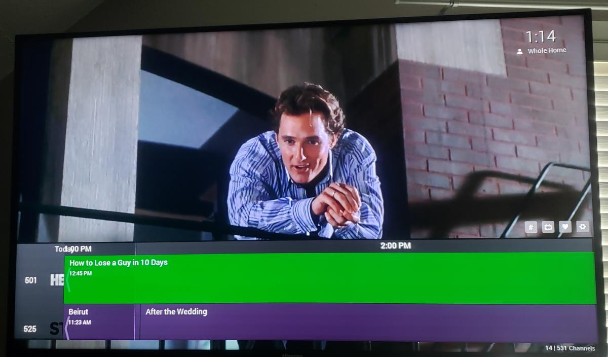

Timmayyy 2 Posted March 13, 2020 Posted March 13, 2020 Just installed emby on android v10.0 tv box and my icons, guide, images are HUGE. Only 3 guide lines per page, covering the icons. Everything is just huge and falling off the bottom of the page even. Cant find a setting to fix it. Tried setting box to 1080 vs 4k, no luck.

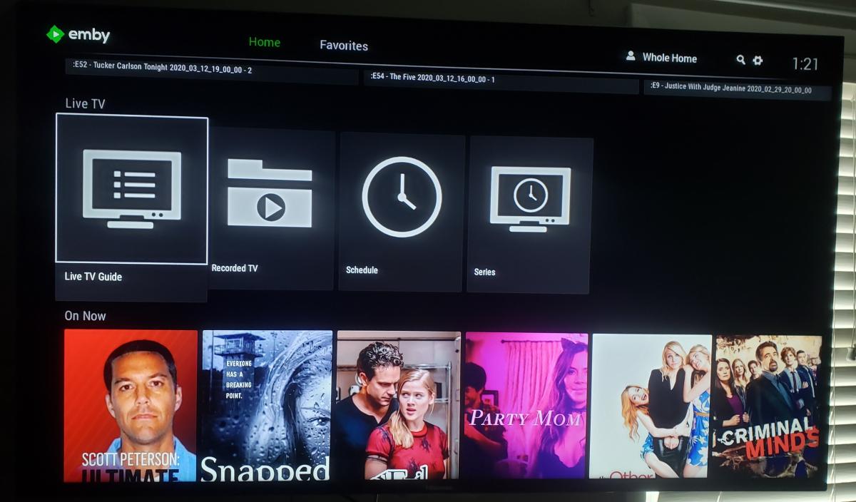

Timmayyy 2 Posted March 14, 2020 Author Posted March 14, 2020 (edited) Sub-guide & guide Sub-guide cover images xl falling off bottom of screen Pause/play/info looks normal Home screen images very large, falling off bottom of screen Edited March 14, 2020 by tsruhnke

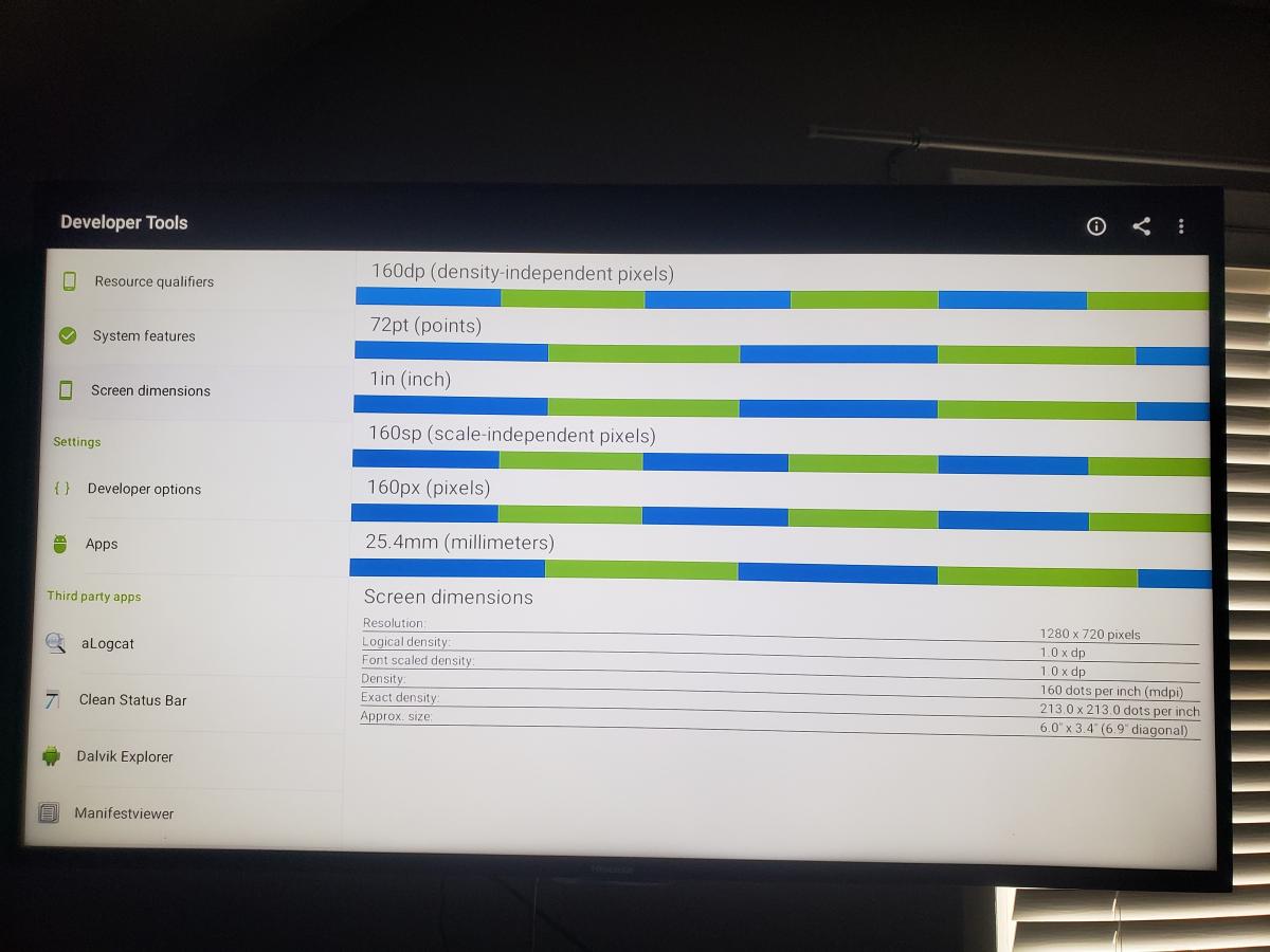

Timmayyy 2 Posted March 14, 2020 Author Posted March 14, 2020 Tried using settings editor to edit ro.sf.lcd_density but it I get an error set edit does not currently support editing this table. Also installed developer tools and can see the pictured screen dimensions.
clarkss12 304 Posted March 14, 2020 Posted March 14, 2020 (edited) Tried using settings editor to edit ro.sf.lcd_density but it I get an error set edit does not currently support editing this table. Also installed developer tools and can see the pictured screen dimensions. DPi should be at least 240. Is your device rooted? Edited March 14, 2020 by clarkss12
Timmayyy 2 Posted March 14, 2020 Author Posted March 14, 2020 DPi should be at least 240. Is your device rooted? Any recommendation on how to change it easily?
clarkss12 304 Posted March 14, 2020 Posted March 14, 2020 Any recommendation on how to change it easily? Which app did you try to change the "ro.sf.lcd_density" that gave you the error?? Make sure your device is rooted. There are tons of DPI apps on the Aptoide store that will work, but you have to be rooted. Been awhile since I had to change DPI, but I always just changed the build.prop setting manually. Lately, I use X-plorer file browser, but you have to manually set it to R/W.
Timmayyy 2 Posted March 14, 2020 Author Posted March 14, 2020 (edited) Finally got it changed. I got up to 265 dpi at 1920x1080 before my other android menus and apps became unusable by zooming in and falling off the screen. It's an ok fix as the sizing is better, but made my other apps odd now. Edited March 14, 2020 by tsruhnke
