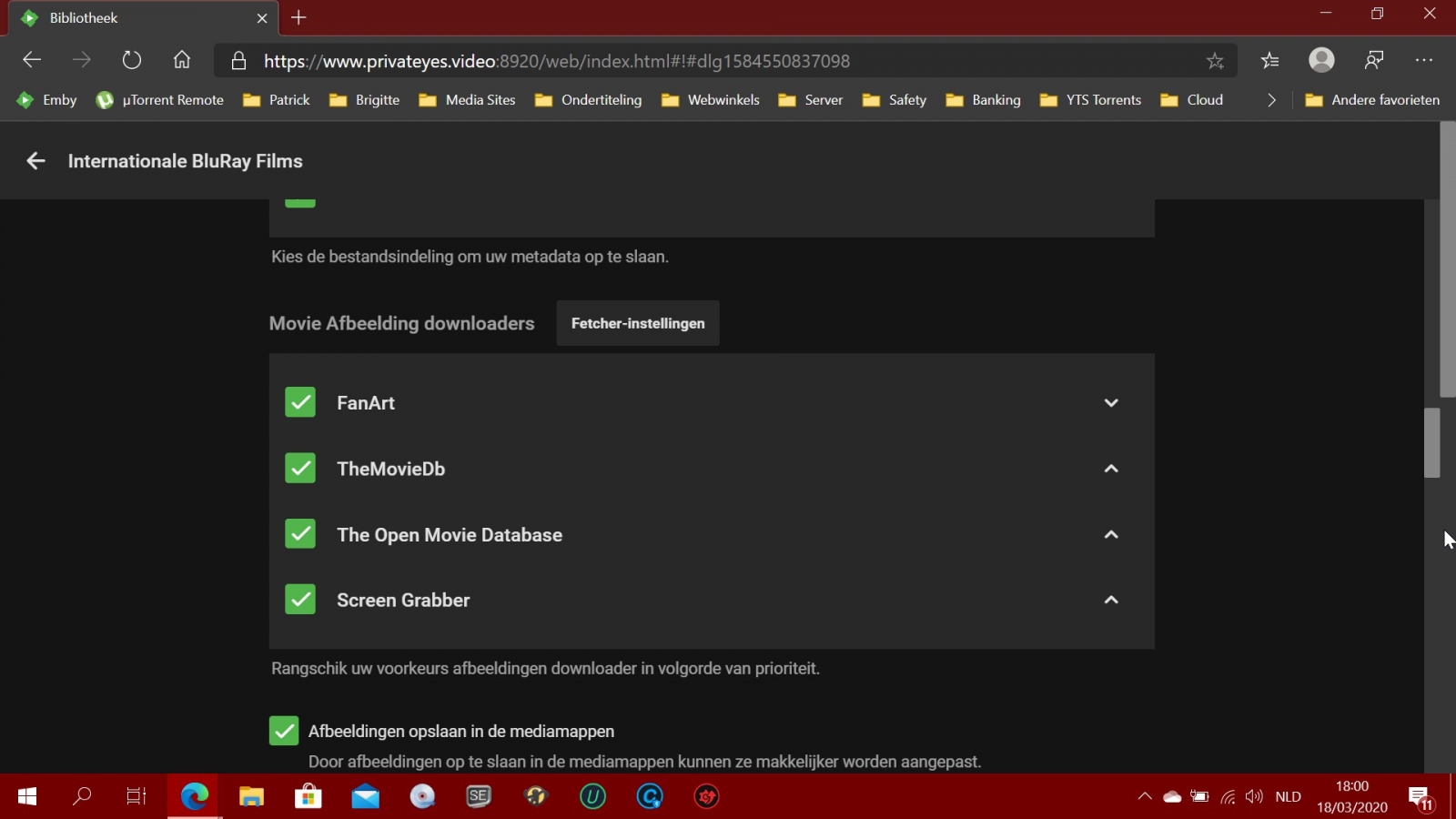

Luke 42213 Posted March 18, 2020 Posted March 18, 2020 hi @@privateyes server Have you checked the settings for your movie library to make sure that the MovieDb image fetcher is enabled? 1

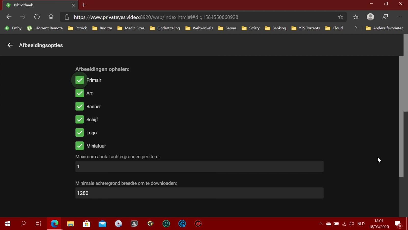

privateyes server 0 Posted March 18, 2020 Author Posted March 18, 2020 The problem is that the posters can be found online at fanart but do not download automatically (this is about movies that were already on them before the SWITCH of the HDD)

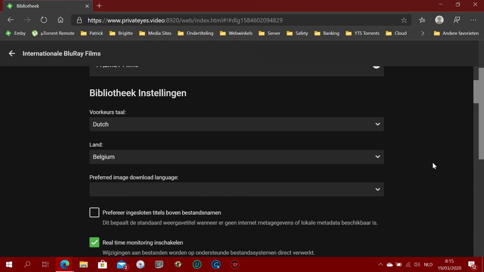

privateyes server 0 Posted March 18, 2020 Author Posted March 18, 2020 The language of the posters selected is 'ORIGINAL
Luke 42213 Posted March 18, 2020 Posted March 18, 2020 There is no such thing as original language. Where are you seeing that? @@Happy2Play ?
privateyes server 0 Posted March 18, 2020 Author Posted March 18, 2020 (edited) Prefered image Downloadlanguage = 'blank' Edited March 18, 2020 by privateyes server
Luke 42213 Posted March 18, 2020 Posted March 18, 2020 There is no such thing as original language. Where are you seeing that? Can you please answer this? thanks.
Happy2Play 9803 Posted March 18, 2020 Posted March 18, 2020 There is no such thing as original language. Where are you seeing that? @@Happy2Play ? Not that I am aware of. Prefered image Downloadlanguage = 'blank' If you don't have a Preferred image download set, I believe your Preferred Metadata and or system language is used.
privateyes server 0 Posted March 19, 2020 Author Posted March 19, 2020 I have nothing changed at the settings of the image fetchinglanguage since I changed my hdd. It works before. By backuping my HDD I Lost several images (+2000) posters, background, logo) and By rescanning the HDD, the images are no longer automatically supplemented
Luke 42213 Posted March 19, 2020 Posted March 19, 2020 Can you please answer the question from earlier when you said this: The language of the posters selected is 'ORIGINAL Where did you see that?
Luke 42213 Posted March 19, 2020 Posted March 19, 2020 So you left it blank, that means it will use your metadata language, which is Dutch. Did you check fanart to see what dutch images they have available?
privateyes server 0 Posted March 19, 2020 Author Posted March 19, 2020 why: If I manually add a movie NOW to the media library (an English language) why will a poster be downloaded (English language) and not the language of my system (Dutch). however, when scanning for missing metadata (including images), new NO images are downloaded.
