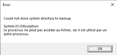

Happy2Play 9806 Posted March 6, 2020 Posted March 6, 2020 I have this error on install... I assume that translates to the folder is still in use, meaning something is holding that folder. Make sure all Emby tabs are closed in your browser and there are still no processes still running. Then try the install again.
Hyp3rD 10 Posted March 6, 2020 Author Posted March 6, 2020 Nothing seem to work, so I have rename the Emby-Server folder and restore a full backup of the folder and everything restart normally... I hope this bug will not happen again ...? How can I save the db of users and server if I ever have to start from scratch? I don't have Emby Premiere, so I can't use the plugin at the moment ... Thanks for your help!
Happy2Play 9806 Posted March 6, 2020 Posted March 6, 2020 Nothing seem to work, so I have rename the Emby-Server folder and restore a full backup of the folder and everything restart normally... I hope this bug will not happen again ...? How can I save the db of users and server if I ever have to start from scratch? I don't have Emby Premiere, so I can't use the plugin at the moment ... Thanks for your help! You can try copying the Emby-Server\programdata folder over to your Portable install replacing the current one. But something on your system is blocking the appdata install.
Luke 42216 Posted March 6, 2020 Posted March 6, 2020 Nothing seem to work, so I have rename the Emby-Server folder and restore a full backup of the folder and everything restart normally... I hope this bug will not happen again ...? How can I save the db of users and server if I ever have to start from scratch? I don't have Emby Premiere, so I can't use the plugin at the moment ... Thanks for your help! We don't know that it's a bug yet , although I apologize for the disruption you are having. It is still possible there could be multiple instances of the server running, which would explain why the folder is locked. How many windows users do you have on the machine?

Happy2Play 9806 Posted March 6, 2020 Posted March 6, 2020 But your issue is within your OS user profile (I am guessing), as you have already reinstalled and a Portable worked. Are you planning to reinstall OS? Did you restore a full system backup or just a backup of the Emby-Server folder? The Emby-server\programdata is all you need to transfer into a new install. Just like the plugin if paths are changing you could have issue. If they are not you are golden.

Hyp3rD 10 Posted March 9, 2020 Author Posted March 9, 2020 Hi, thank you for the offer, but like I had say there: Nothing seem to work, so I have rename the Emby-Server folder and restore a full backup of the folder and everything restart normally... Everything work perfect for now, but I didn’t find what had cause this issue, I hope that it was a isolated event. Thank you very much for your followed. Have a nice day!
