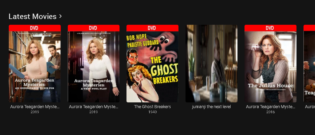

chrisrobbins1970 82 Posted February 29, 2020 Posted February 29, 2020 can't seem to add Jumanji The Next Level to my movies.. i have tried using the title, IMDB ID number.. it wont scrap to find the metadata.. SORRY, but plex finds it with no issues

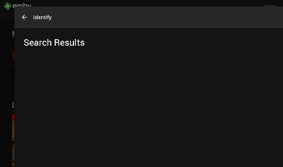

chrisrobbins1970 82 Posted February 29, 2020 Author Posted February 29, 2020 yep named it Jumanji The Next Level (2019).. this is what I get from screenshot
chrisrobbins1970 82 Posted February 29, 2020 Author Posted February 29, 2020 ive removed it.. re-scrapped.. added back in.. still not adding metadata

chrisrobbins1970 82 Posted February 29, 2020 Author Posted February 29, 2020 tried that... used Jumanji to identify..and i get..screenshot...

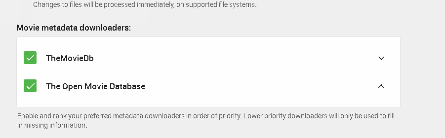

samuelqwe 317 Posted February 29, 2020 Posted February 29, 2020 (edited) I would make sure you have the proper movie metadata downloaders set up for the library in which the movie resides in. You might have one of the providers that provides the metadata disabled. There's really only two options, but if you have TheMovieDB enabled, it should show up. Edited February 29, 2020 by samuelqwe
chrisrobbins1970 82 Posted February 29, 2020 Author Posted February 29, 2020 ok.. i may have spoke too soon... turns out other movies are having same issues... Emby not scrapping and old movies..WTF
samuelqwe 317 Posted February 29, 2020 Posted February 29, 2020 thought if that... Since you have everything enabled, it's really odd that it's not showing up for you. Perhaps the API requests are being blocked somewhere, however that shouldn't be the case if Plex still fetches the metadata for you.
