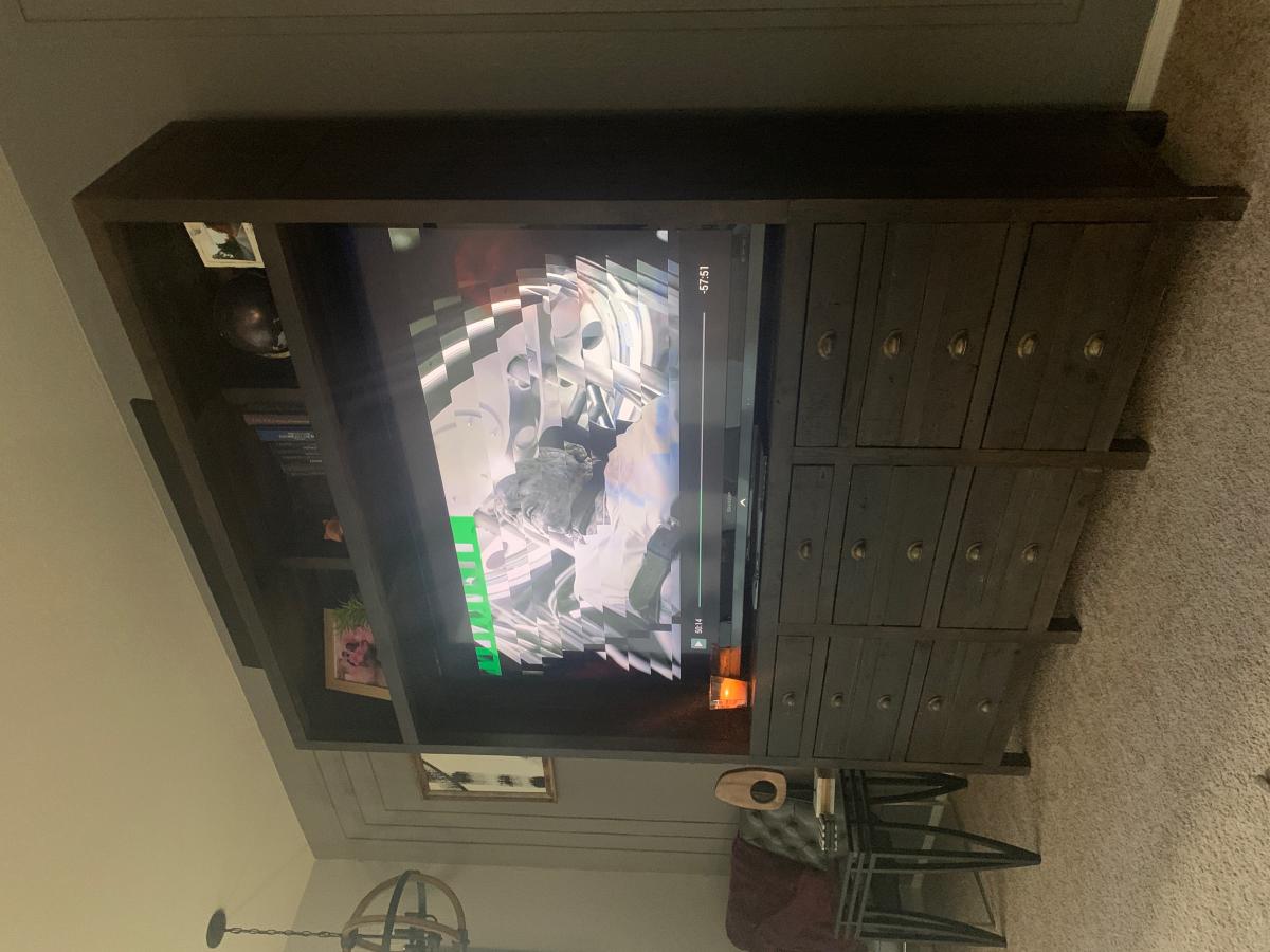

JoeBob0131 2 Posted February 25, 2020 Posted February 25, 2020 So multiple people with firesticks are starting to have this problem when using my server. I attached a picture. I am pretty sure it is caused by transcoding, but was wondering if anyone experienced something similar. These people are not very tech savvy so it is hard to troubleshoot the problem with them. What information can I provide to help solve this issue? Thanks!

ebr 16338 Posted February 26, 2020 Posted February 26, 2020 Hi. Yes, please provide those details. Are these HEVC videos? Tell your users to use the "Playback Correction" option under the cog menu during playback.

JoeBob0131 2 Posted March 1, 2020 Author Posted March 1, 2020 (edited) So I was able to reproduce the error, and it is a bit weird. I have remote clients limited to 2MB/s, which means most videos transcode. So I did some testing with that, and if I bring the limit down to 1MB/s or up to 3MB/s it works fine. So it only has this problem when limited to 2MB/s or 1.5MB/s. I will PM you my logs. Edit - I did try and use the playback correction and it did not fix anything. The only way to fix it is to make it not transcode, or change the limit to 1MB/s or 3MB/s. Edited March 1, 2020 by JoeBob0131

Luke 42246 Posted March 3, 2020 Posted March 3, 2020 As a test, if you disable hardware acceleration in the server transcoding section, does that help?
JoeBob0131 2 Posted March 5, 2020 Author Posted March 5, 2020 As a test, if you disable hardware acceleration in the server transcoding section, does that help? Yes, turning off hardware acceleration does fix the issue, though I would prefer to have it on!

JoeBob0131 2 Posted March 6, 2020 Author Posted March 6, 2020 @@JoeBob0131 - I might, but you'd need to add me to the PM. Looks like you were added. And just to confirm, the issue is only happening on my Firestick when limiting video to 1.5MB/s or 2MB/s, which is weird! I tested on my shield and it doesnt experience the same issue. Also the issue appears regardless of remote or local connection.
softworkz 5133 Posted March 6, 2020 Posted March 6, 2020 Thanks, I've seen it now. I agree that it's a weird issue. I have a few ideas we could check for: First one: The "bandwidth selection" does not only select a bandwidth but also a resolution. What you could do is to enable "Stats for nerds" and watch the resolution in different cases. When it's the same when hw or sw encoding, then that would be a dead end, though. For the the other things to check, you would need to install the Diagnostics Plugin: https://mediabrowser.github.io/Emby.DiagnosticsPlugin/ Then we can try a few things and do some analysis on the generated hls segments...
JoeBob0131 2 Posted March 7, 2020 Author Posted March 7, 2020 Thanks, I've seen it now. I agree that it's a weird issue. I have a few ideas we could check for: First one: The "bandwidth selection" does not only select a bandwidth but also a resolution. What you could do is to enable "Stats for nerds" and watch the resolution in different cases. When it's the same when hw or sw encoding, then that would be a dead end, though. For the the other things to check, you would need to install the Diagnostics Plugin: https://mediabrowser.github.io/Emby.DiagnosticsPlugin/ Then we can try a few things and do some analysis on the generated hls segments... So I checked the resolutions, and they are the same in HW and SW transcode. The resolution that creates the problem is 720x405 which is what it runs at when I set it to 2MB/s. 1280x720 @ 3MB/s and 640x360 @ 1MB/s both run fine. SW transcode also does not have an issue with any resolution. I can install that Plugin, what information would you like me to provide and what scenarios? Just the one where it doesnt work?
softworkz 5133 Posted March 7, 2020 Posted March 7, 2020 Are you sure about "720x405"? Because in the log you sent, it was "720x404"
JoeBob0131 2 Posted March 7, 2020 Author Posted March 7, 2020 (edited) Are you sure about "720x405"? Because in the log you sent, it was "720x404" Yup! That is what the stats for nerds window says. I did just check the log for the transcode and it does say 704 though. So maybe a discrepancy between the two. Edited March 7, 2020 by JoeBob0131
JoeBob0131 2 Posted March 7, 2020 Author Posted March 7, 2020 How does sw transcoding compare? sw transcoding has no issue and displays at the same resolution.
softworkz 5133 Posted March 7, 2020 Posted March 7, 2020 I meant whether you see the same discrepancy of resolutions in case of sw transcoding?
JoeBob0131 2 Posted March 7, 2020 Author Posted March 7, 2020 Gotcha, yea, the log still shows 720x404.
softworkz 5133 Posted March 7, 2020 Posted March 7, 2020 OK, then it's probably not a problem with the resolution. Let's move on: First test: In the Diagnostics plugin, activate "Legacy Command line building" and retry.
