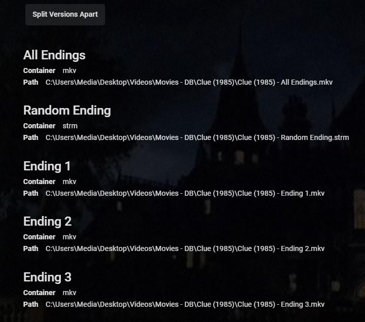

crusher11 1153 Posted February 28, 2020 Author Posted February 28, 2020 I knew about split files, didn't realise it was also called file stacking. So "A Ending" etc should work?
Happy2Play 9814 Posted February 28, 2020 Posted February 28, 2020 (edited) I knew about split files, didn't realise it was also called file stacking. So "A Ending" etc should work? In my tests NO any use of "1 through 9 or A through D" gets I would assume stacked, but they do not show up as additional parts. Edited February 28, 2020 by Happy2Play
crusher11 1153 Posted February 28, 2020 Author Posted February 28, 2020 *sigh* Why does my server have to suffer because other people can't name their files properly?
crusher11 1153 Posted February 28, 2020 Author Posted February 28, 2020 What exactly is the stacking logic? It can't be any instance of those characters because "Cut" includes a C and all my "Director's Cut" versions and such work fine.
Happy2Play 9814 Posted February 28, 2020 Posted February 28, 2020 What exactly is the stacking logic? It can't be any instance of those characters because "Cut" includes a C and all my "Director's Cut" versions and such work fine. Only @@Luke can answer that but " - AEnding" and " - EndingA" don't work either, but " - AAEnding", " - EndingAA", " - AA Ending", " - Ending AA" work. Don't know if I just tested too many variables but " - Ending 1", " - Ending 2", " - Ending 3" and " - 1 Ending", " - 2 Ending", " - 3 Ending"are working. So numbers are currently working for me, but A through D do not.

crusher11 1153 Posted February 28, 2020 Author Posted February 28, 2020 Apparently that includes literally all the filenames that would be appropriate because you've made the stacking trigger way too damn broad in order to appease people who refuse to properly name their files, though, so WTF am I supposed to do? "Ending A" won't work. "A Ending" won't work. "Ending 'A'" won't work. Why am I even bothering? And the stupidest part of this whole issue is that file stacking isn't even actually supported, because when I was trying to stack files due to a multi-aspect-ratio movie I had, and it utterly failed to register the second "part", I was told to give up and re-encode because file stacking wasn't popular enough to be supported in a way that actually functioned. And yet, when I'm trying to do something else, file stacking is so supported I'm going to be stuck naming my files "The Ending That Comes First" or something absurd like that because everything else that makes sense gets picked up as a stacked file, which because it isn't supported in any other way means the file completely disappears from my server and is impossible to access.

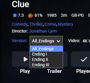

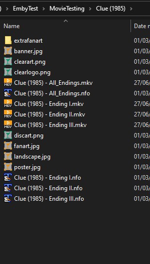

PenkethBoy 2068 Posted March 1, 2020 Posted March 1, 2020 Not sure what others have tried ..... Use Roman numerals - then multipart movies work (You dont need the underscore for All_Endings that was just me trying something out) 1
