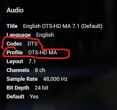

FrostByte 5454 Posted February 21, 2020 Posted February 21, 2020 How can you tell if it's passing the correct stream in SFN? My SFN for a DTS-X stream is saying something similar and I'm pretty sure it's passing the correct stream because my soundbar is lighting up "DTS-X" which is the DTS-HD MA stream. My SFN however shows something similar to the above pic, but the channels are 7.1 (some DTS-HD of course can be 5.1 though) and it doesn't show the bitrate (I assume because it's lossless it doesn't show bitrate?) If SFN showed the profile instead of the codec I could tell because the codec for lossy and lossless is both DTS. The Profile for DTS-HD MA is just that while the profile for DTS is "DTS"

FrostByte 5454 Posted February 21, 2020 Posted February 21, 2020 Ok, I assume it's working because my soundbar says so and it says Direct is there any way you can change SFN to show the profile though instead of the codec? The profile on the web client shows DTS-HD MA while the codec is DTS 1
FrostByte 5454 Posted February 21, 2020 Posted February 21, 2020 It's the same with all DTS-HD (no matter channels or if it has X or not) it always says codec DTS. At least with the profile we would know for sure if the stream had HD, especially with 5.1
FrostByte 5454 Posted February 21, 2020 Posted February 21, 2020 Same movie in the web client showing profile Now if the channels are 7.1 then I can assume it's DTS-HD, but if it's 5.1 channels the only thing I can tell is that lossey shows the bitrate and lossless doesn't 1
