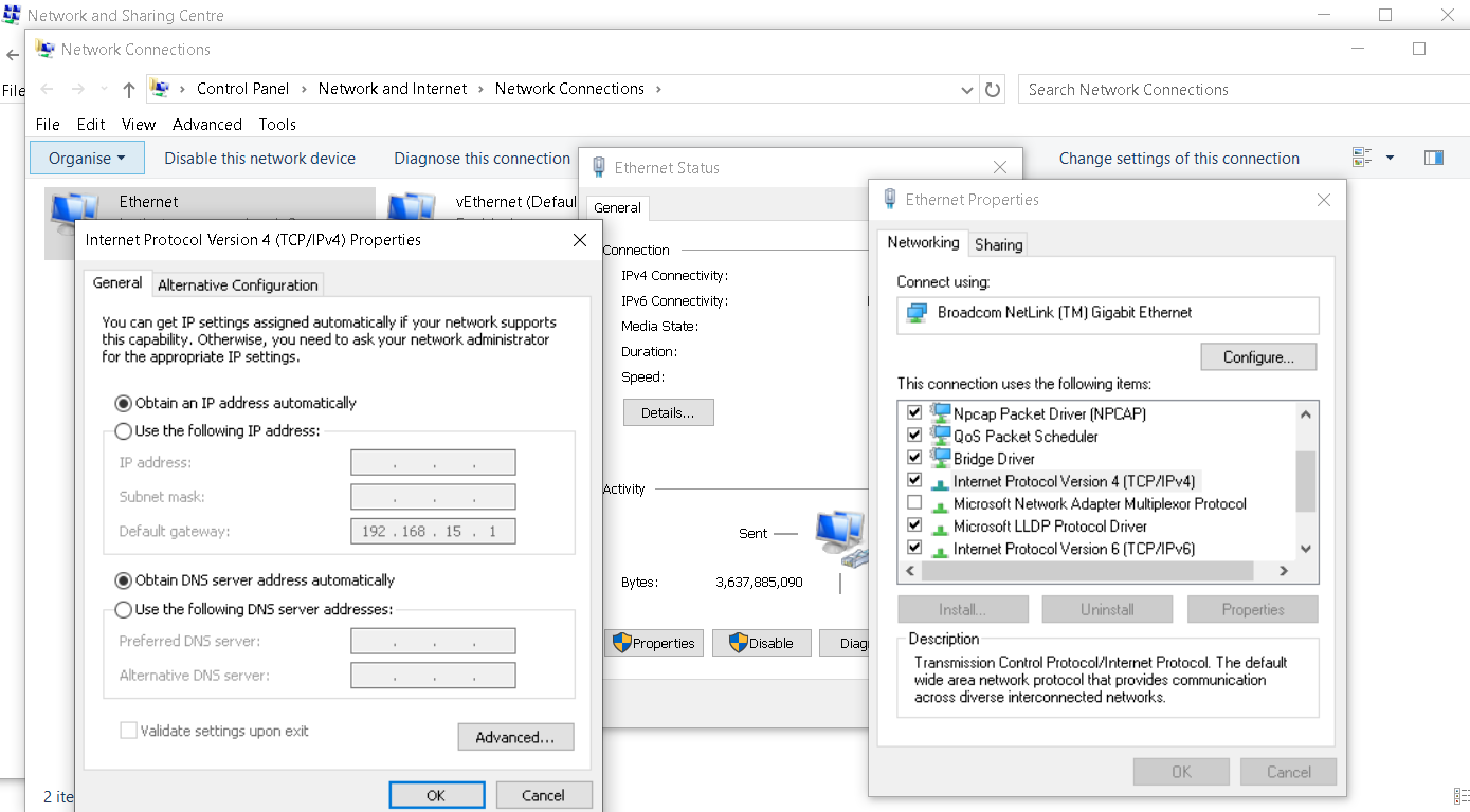

denz 501 Posted February 20, 2020 Posted February 20, 2020 (edited) The only way is that you need to change the computer ip that hosts emby. On your pc it would have use the following ip address ticked and the old ip address Edited February 20, 2020 by denz

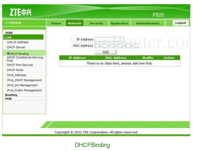

denz 501 Posted February 20, 2020 Posted February 20, 2020 (edited) What is the model number of your router ? There are two ways first If you have changed your emby server to a static IP address on your router there should a setting under DHCP or lan settings to reserve/binding that address just in case your emby server is off another device may pick up that address. The other way is if your emby server has now a different ip address to reserve it so no other device picks it up. Then that ip address you use to connect to your emby server. As the poster above have said there is always other ways but sometimes you don't want to over complicate things. If you attach pictures of the router settings it would be easier to assist. Edited February 20, 2020 by denz
denz 501 Posted February 20, 2020 Posted February 20, 2020 (edited) I couldn't find a manual but it is probable similar to this have a view of this page on your router and see what you have in dhcp binding is there a option there to reserve the address of emby server. So you pick up the mac address and the ip address of emby server and enter that info in dhcp binding and then emby will always get the same address. Edited February 20, 2020 by denz
Anixd 9 Posted February 20, 2020 Author Posted February 20, 2020 (edited) here is the page - emby is not written here where is mac address and ip address of emby server? Edited February 20, 2020 by Anixd
denz 501 Posted February 20, 2020 Posted February 20, 2020 (edited) Can you attach a screenshot of the dhcp server setting there should be a list of your devices and on one of them should be your emby server and just copy those details into the dchp binding page so emby server always gets that address. Edited February 20, 2020 by denz
