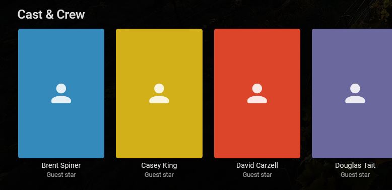

centuryx476 9 Posted February 19, 2020 Posted February 19, 2020 (edited) Hello, I have noticed I am getting this weird error on the server. This constant "System.IO" cannot find directory error. I have also noticed that some metadata pictures of actors are not appearing. They are replaced with generic Sign-in pics. I attached the server log. Let me know Thank You embyserver_Log.txt Edited February 19, 2020 by centuryx476

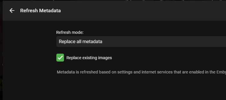

centuryx476 9 Posted February 20, 2020 Author Posted February 20, 2020 That's one issue as the People are already in the database so refreshing the show does not really do anything for cast and crew. Does the person return if you click on them? Do they return if you Refresh the person? When I click on the individual person and refresh with the option to replace images. It does it refresh but with the same result.
Happy2Play 9806 Posted February 20, 2020 Posted February 20, 2020 (edited) It does actually because the media metadata download is when people images are obtained. But if actors are disappearing, I would not think they are being fetched as they technically already existed. When I click on the individual person and refresh with the option to replace images. It does it refresh but with the same result. Can you please post that server log. Edited February 20, 2020 by Happy2Play

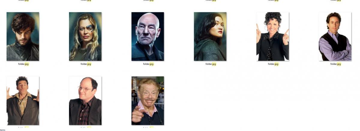

centuryx476 9 Posted February 20, 2020 Author Posted February 20, 2020 I opened the metadata folder And the pictures are there which is a good thing. At least its downloading See "Emby_Pics_2.jpg" But in Emby I see this See "Emby_Pics_3.jpg"
Happy2Play 9806 Posted February 20, 2020 Posted February 20, 2020 I opened the metadata folder And the pictures are there which is a good thing. At least its downloading See "Emby_Pics_2.jpg" But in Emby I see this See "Emby_Pics_3.jpg" Where are these image in metadata folder? Almost sounds like a database Images path issue. I am not seeing anything in the log, can you enable Debug logging. Dashboard-Logs Note enabling and disabling this option requires a server restart to start or stop this option.

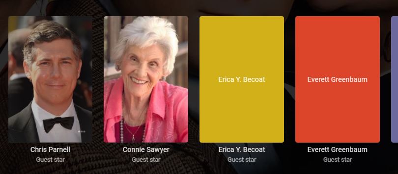

centuryx476 9 Posted February 20, 2020 Author Posted February 20, 2020 (edited) Update: I switch to the beta version of emby. This time when I refresh the metadata for an individual actor. Their respective picture comes up. See attached As you can see the two actors I refreshed are now showing up. I also attached a server log embyserver_Log(Beta).txt Edited February 20, 2020 by centuryx476
maegibbons 1287 Posted February 20, 2020 Posted February 20, 2020 Welcome to the Emby Beta Testers group! There are some pros to running the beta. Krs Mark Sent from my SM-N976B using Tapatalk
centuryx476 9 Posted February 20, 2020 Author Posted February 20, 2020 Welcome to the Emby Beta Testers group! There are some pros to running the beta. Krs Mark Sent from my SM-N976B using Tapatalk Hello, It is not working for every actor. Also, it is counter productive for me to refresh the metadata for each individual actor. But at least It is sorta working with the beta. Not sure what else to do...
