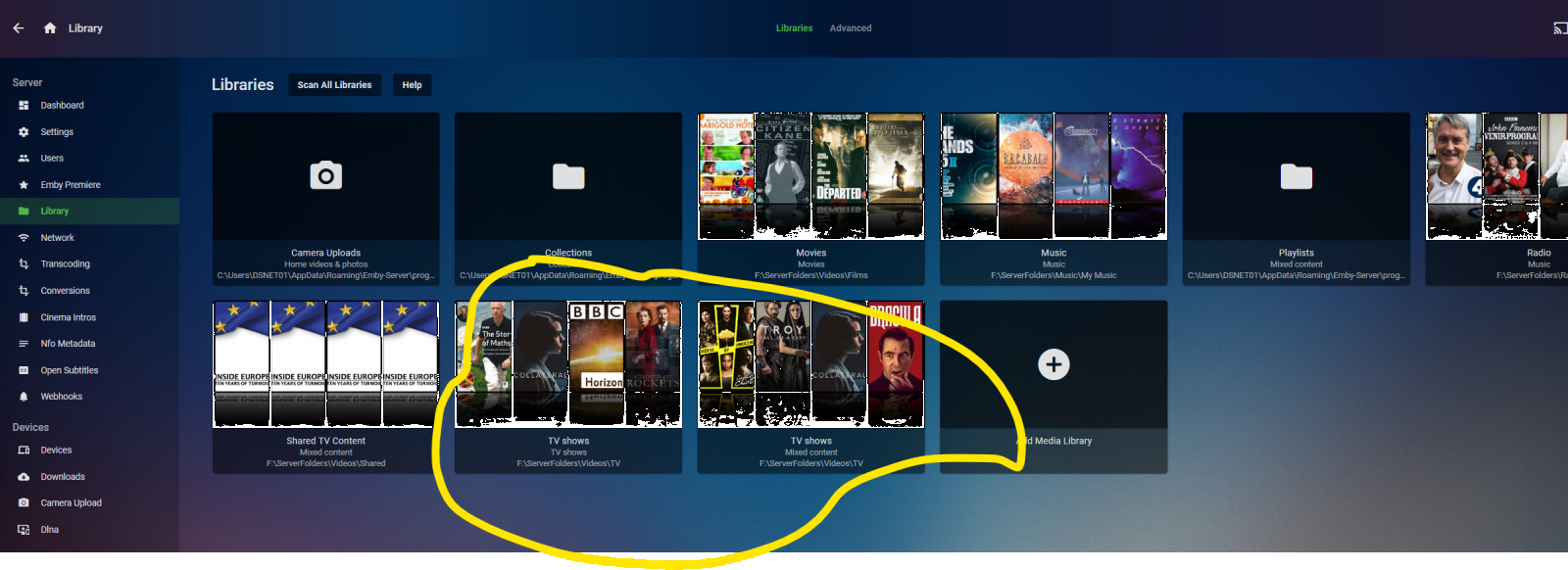

martinix 2 Posted February 16, 2020 Posted February 16, 2020 Hi, I was experiencing problems with a Music library. I backed up the database using the 'Server Configuration Backup'. Having done this, I did a clean server install to experiment with fixes for the music library. After all this I reverted back to the original installation. I did this by completely uninstalling Emby and then doing a clean reinstall of the server and restored the backup Configuration copy. Following this, I'm getting a problem with duplicated Icons for the TV Shows library appearing on the home screen [see picture below]. I tried deleting the cache and restarting the server but this had no effect. Is there some way of getting rid of the duplicate icons without having to rebuild the whole library? Is there someway of cleaning the Emby Database to remove such anomalies? Many thanks.
Luke 42216 Posted February 16, 2020 Posted February 16, 2020 Hi there, does it show in library setup multiple times?
martinix 2 Posted February 16, 2020 Author Posted February 16, 2020 Hi, Two show but one does not [ see picture below]. One shows with the correct folder/type, the second library shows with the correct folder but as a 'mixed type' of content. The 3rd library 'TV Shows 1' doesn't show on the server library manager view.
Luke 42216 Posted February 17, 2020 Posted February 17, 2020 Ok you'll need to delete one of those anyway as it's not really supported to use the same folder multiple times with different content types. I would do that, then run a full scan and see where things stand.
