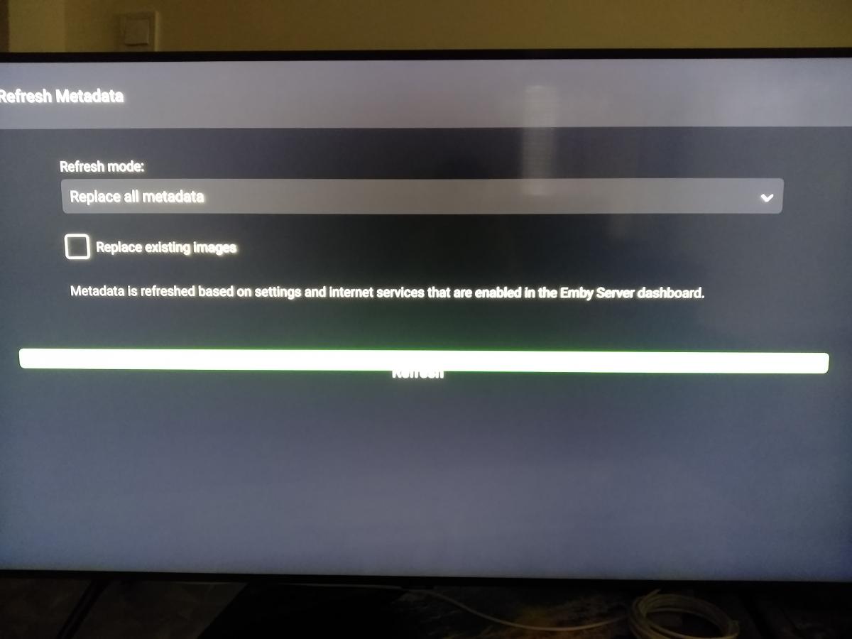

psxlover 32 Posted February 15, 2020 Author Posted February 15, 2020 Yes the TV is a 2019 model It is happening with multiple videos, I tried playing videos from at least 3 anime series. Playback starts briefly, for perhaps less than second, then screen turns black with the loading animation playing. As if the application thinks there is an issue, and decides to change stream to transcoding. I attached logs from 1.0.70 and 1.0.74 in case they help. I also tried playing a video that would require transcoding (an anime in H264 10bit encoding with the subtitles turned off), to check if there was an issue with playing transcoded videos that was already there and I never noticed, and the video plays fine (as fine as it can be when using a server not powerful enough to transcode) on 1.0.74, so there is no issue with transcoding in general. Another minor issue, completely unrelated with this, is that some buttons don't show up correctly in my TV (see attached images). I'm not sure if it also happens when using the browser of the TV, because that menu is not available when I visit the server over the browser. The screen I first noticed it on is the one that occasionally pops to say about Emby Premiere. While in that screen we can't scroll but I remember in older versions that there was a timer on the disabled button. Now the button is off screen, and you can't do anything until the time period elapses, on which time I think you have to press down to get to the button after it has been enabled. This would probably lead to people thinking the app has frozen or something. I first encountered this quite some time ago, it was already there in 1.0.70. I guess nobody reported it before. embyserver 1.0.70.txt embyserver 1.0.74.txt
