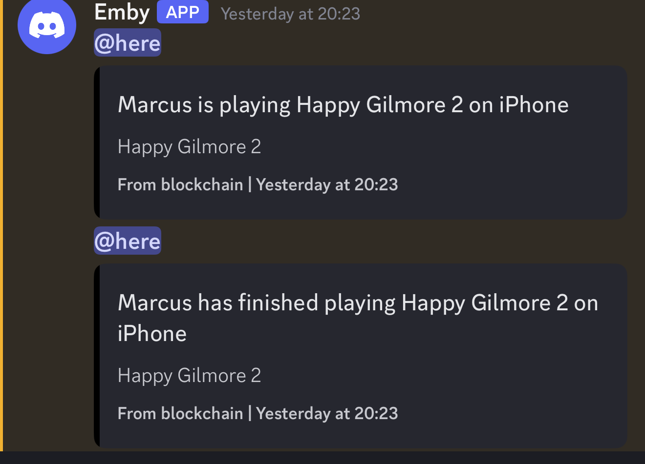

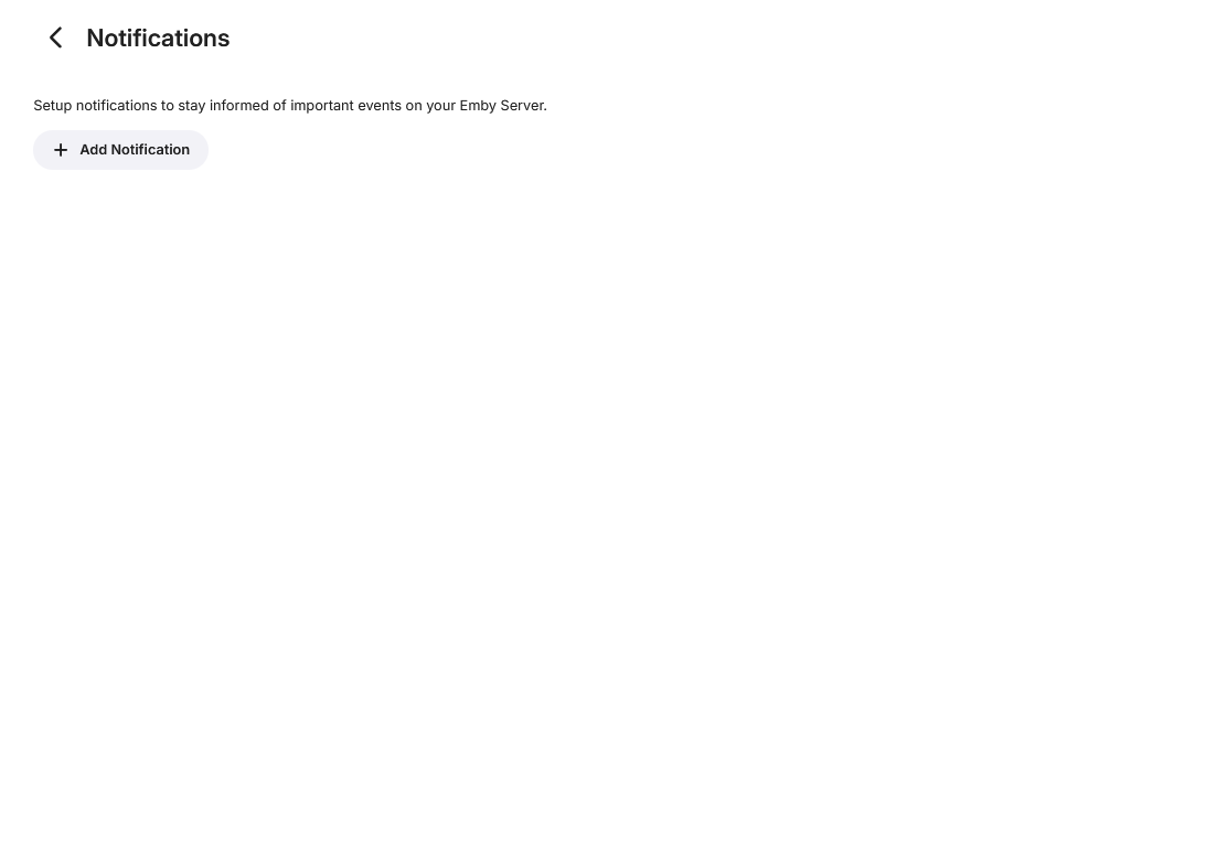

Mac18 7 Posted December 26, 2024 Posted December 26, 2024 9 minutes ago, kjhedges said: Have you tried removing the emby token you use for discord and remove webhook from discord and reconfigure with a new token? Sorry, my mistake. No emby api key needed. I was planning too. but still i need to find out where is the hidden notification that has been deleted before, Maybe because it is still running in the background
Mac18 7 Posted December 26, 2024 Posted December 26, 2024 28 minutes ago, Mac18 said: I was planning too. but still i need to find out where is the hidden notification that has been deleted before, Maybe because it is still running in the background I just did and I received an error on the logs for the old webhook notification,. logs.txt
Luke 42251 Posted December 26, 2024 Posted December 26, 2024 10 hours ago, Mac18 said: Hi @Lukethere is only one notification configured, as I mentioned last time the firs configuration has been deleted or missing after the update so i reconfigure again. Have you checked other users on your server? They could have notifications configured as well.
Luke 42251 Posted December 26, 2024 Posted December 26, 2024 9 hours ago, Mac18 said: For the record also, I just now tried to. uninstall discord plugin restart the server install discord plugin restart the server and immediately i received a notification from discord "the server has been restarted" without any configured notification, is there any way to manually delete the old configured notification that the emby does not detected? if there is, can you give me the path of notification config so i can delete the folder or files. and reconfigure again None of those actions will clear existing saved configurations, just FYI.
Mac18 7 Posted December 26, 2024 Posted December 26, 2024 (edited) 55 minutes ago, Luke said: Have you checked other users on your server? They could have notifications configured as well. Hi @Luke Thanks. I guess it solved the problem. The Other user that has an admin rights has a notification configured., I thought the settings is global for all admin users, not as per user. Edited December 26, 2024 by Mac18 1
Luke 42251 Posted December 26, 2024 Posted December 26, 2024 1 hour ago, Mac18 said: Hi @Luke Thanks. I guess it solved the problem. The Other user that has an admin rights has a notification configured., I thought the settings is global for all admin users, not as per user. Hi, no, each user is able to setup their own.
