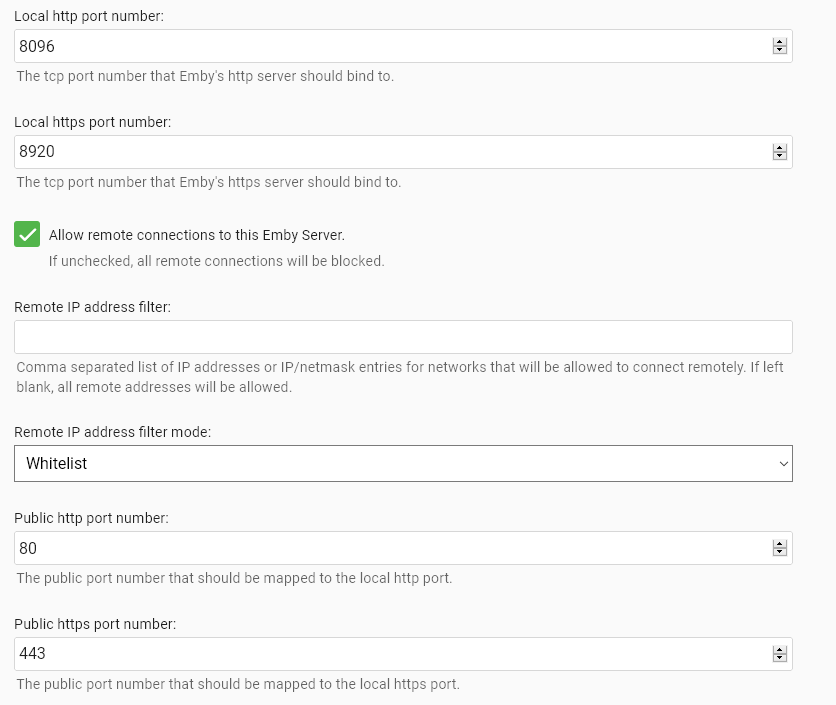

tomnjerry74 97 Posted February 7, 2020 Author Posted February 7, 2020 Is nginx/Caddy on the same machine as Emby? Your message reads to me as if it is. In that case, Emby must listen on different ports from those listened on by the proxy - on a given machine only one program can listen on each port. Typically, the proxy would use 80/443 and forward to Emby on 8096. If you then attempt to access Emby on 80/443, you will only get through if the proxy is working and set up right. You can check or use Emby without the proxy by specifying the port 8096 in the call to it. Paul Paul thanks so much for the response Yes, everything's on the same windows machine. I originally had my ssl set up in emby itself but was just trying to change over to the reverse proxy. Would you happen to know why it's not working if these are my settings? caddy settings: my.emby.server { proxy / 127.0.0.1:8096 } emby settings: I'm just getting a little confused with all of the different port numbers. Are you saying I should change the emby ports at the bottom? If so, does it matter what they are?
KMBanana 116 Posted February 7, 2020 Posted February 7, 2020 You have it set correctly. Public is what port devices should connect to to reach your server (so the reverse proxy ports). Local is the ports emby actually is running on that the reverse proxy passes to. The most common reason why something can't bind to 80 is something is already using the port. Could also be windows firewall interfering but I think the former is more likely your issue.

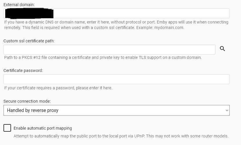

tomnjerry74 97 Posted February 10, 2020 Author Posted February 10, 2020 (edited) It occurred to me to check that you have actually opened port 80 through your router as well as 443. It would be easy to think you only need 443 if you are using https, but Let's Encrypt uses 80 for the verification required to validate the certificate request. Paul I have caddy up and running now and it says: Serving HTTPS on port 443 https://my.domain.com Serving HTTP on port 80 http://my.domain.com However, when I try and access my site I'm greeted with a connection error. I seriously just don't know what to do at this point. This is what my emby settings look like now, maybe something is wrong there? My log file is also showing this now: 2020/02/10 17:23:28 [INFO] Caddy version: v1.0.4 2020/02/10 17:23:28 [INFO][cache:0xc0001bc0f0] Started certificate maintenance routine 2020/02/10 17:23:29 [INFO] Serving https://my.domain.com 2020/02/10 17:23:29 [INFO] Serving http://my.domain.com 2020/02/10 17:26:42 http: TLS handshake error from [::1]:49998: no certificate available for 'fonts.googleapis.com' 2020/02/10 17:26:42 http: TLS handshake error from [::1]:49997: no certificate available for 'fonts.googleapis.com' 2020/02/10 17:32:31 http: TLS handshake error from [::1]:50160: no certificate available for 'fonts.googleapis.com' 2020/02/10 17:32:31 http: TLS handshake error from [::1]:50159: no certificate available for 'fonts.googleapis.com' Edited February 11, 2020 by tomnjerry74
Solution pwhodges 2028 Posted February 11, 2020 Solution Posted February 11, 2020 I helped the OP sort this through PMs. The issue was that the router was port-forwarding from 80/443 to the default Emby ports, and this forwarding had not been removed to enable those ports to go to the same ports in Caddy. Once this was done, everything fell into place. Paul 1
